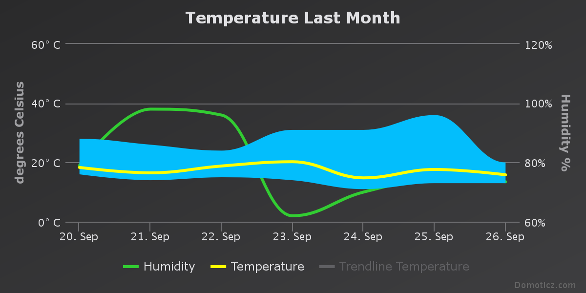

I use the tx300 now in our vegetable garden (in the netherlands) for one week now. On the internet and on this forum i searched for below which humidity level i should irrigate. I could not find this question/answer.
What is your experience?

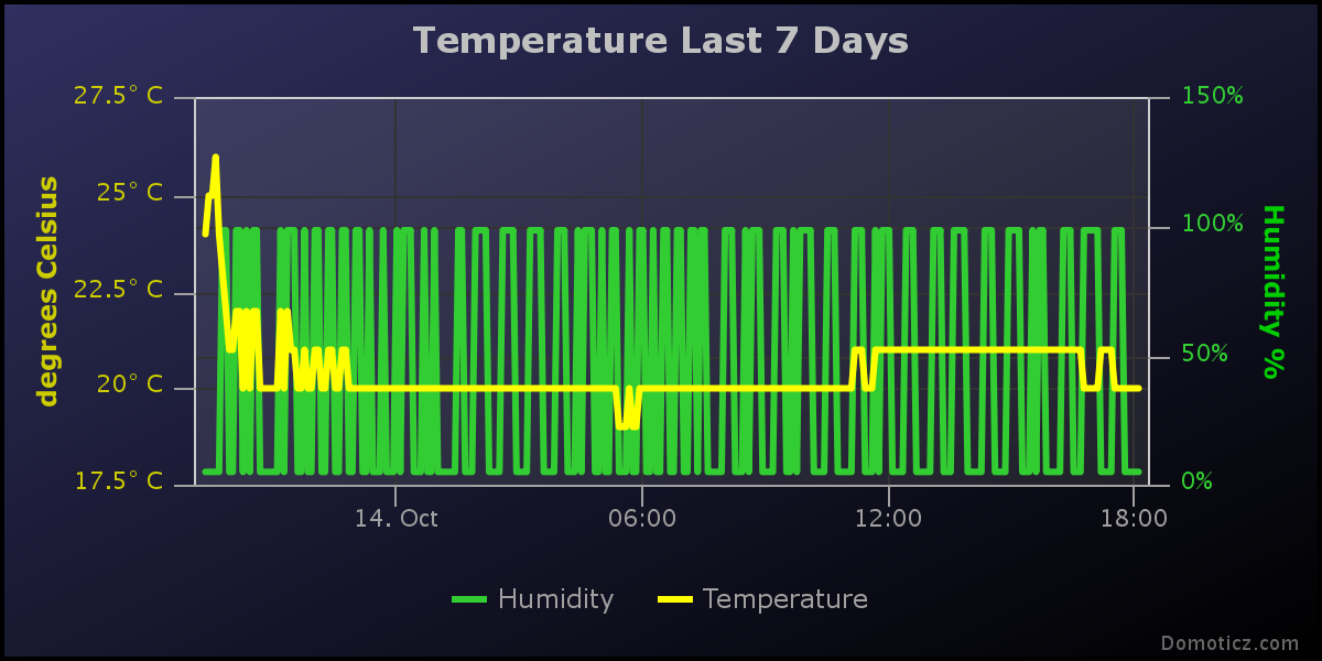

Not quiet sure if I may reply to this topic with a new question or should start a new topic... but I have the same device and thought this would be the best place?
I bought two Imagitronix moisture sensors. One of them is found by Domoticz immediately, the other isn't found at all. Reinstalling the batteries didn't work. Any suggestions?
The second issue is with the sensor that is found. The humidity level is switching between 100% and 0% constantly. Is this a matter of tuning the software side or maybe a hardware issue?

Re: TH12 - Imagintronix Moisture sensor
perhaps it helps when you change the channel on the device
