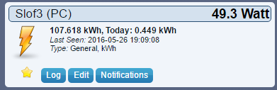

Daily Energy Report
I've a Qubino ZMNHBD2 and with the proper config file and associations Works fine. It send power report properly and so.
But I've seen that Energy Meter is not good.
I would to know how the daily Energy Power consumtion is calculated? it it's calculated by Domoticz or by OpenZwave or by the device (firmware)?

Add some info.
I have seen that Domoticz (or zwave or...?) calculates daily energy usage by substract last reading from actual Reading. That's if last Reading was 1,4 kwh and today it's 1,5 then daily usage is 0,1 kwh. But if today the usage is 0,08 kwh then the result is 0 kwh because the meter reports just one decimal. It cannot manage 1,48, ti is reported as 1,4.
I would like how or in what file is the code to do this calculation. I think this data (kWh usage) can be calculated using watts meter and time, so it would be more accurate.

we use the counter value of the meter, that is the only accurate way to calculate
Last counter value <minus> first counter value of the day <equals> total usage
