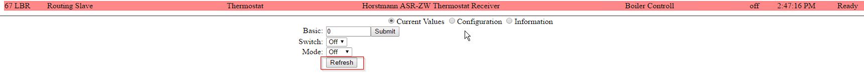

Having had a lot of issues with my Horstmann Boiler transmitter/receiver setup (HRT-ZW & ASR-ZW) I have now simplified things to just using the receiver - I have temperature sensors in rooms already, so don't need the transmitter.
The issue I'm still having is that if i press the on/off buttons on the receiver, it does NOT update in Domoticz (however, going into the OpenZWave control panel and refreshing node info DOES get the new state).
Polling IS enabled for the device, but it makes no difference, so i can only assume there's a bug with Domoticz getting status change alerts from the ASR-ZW receiver.

Is there a way of running "Refresh" in the OpenZWave Control Panel against a specific device?
This might then resolve the issue if i script this every x seconds/minutes.

In the OpenZWave Control Panel page is there a way i can somehow call via URL or some other function a "click" on the refresh item for the node selected (node is 67 in this case)?
This seems to be the only way to get the current status of the Hortmann ASR-ZW.

Yet another update to this.
The issue is OpenZWave, so looks like no fix for it :(
https://groups.google.com/forum/#!searc ... G21jonBgAJ
I'll either have to put up with it and remember NOT to change settings at the control switch or get rid of the device altogether

Hmm, NOT the same here if i manually refresh node in OpenZWave Control Panel the Last Seen date/time updates for the Mode and not the Switch.
However, if I manually operate the ASR-ZW from its on/off button, neither Mode nor Switch update until i run the refresh from OpenZWave Control Panel.
