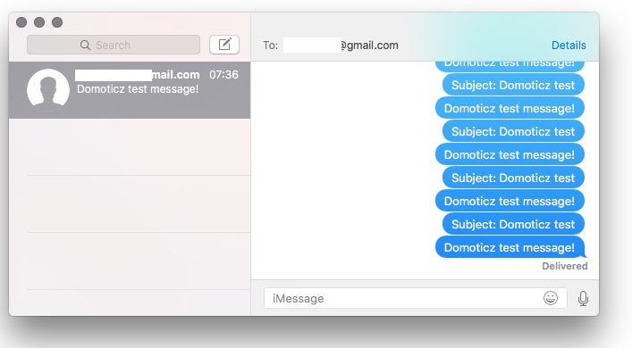

I have domoticz running on OSX and I use this for notification iMessage. I suggest you create a new appleid for your osx domoticz server. Login to it with the message app. Now you can use this account to send imessages (you can use your own account but it nicer not to)
notify.sh
#!/bin/bash
osascript ~/Smarthome/domoticz/scripts/imessage.scpt "[email protected]" "Subject: $1"
osascript ~/Smarthome/domoticz/scripts/imessage.scpt "[email protected]" "$2"
Note that you have to change the path to your install folder. [email protected] is the buddy (not my terminology) or account/telephonenumber you want to send the message to. No idea how to make one message with a return into the message from the command line. But this will due... besides two beeps might be important!

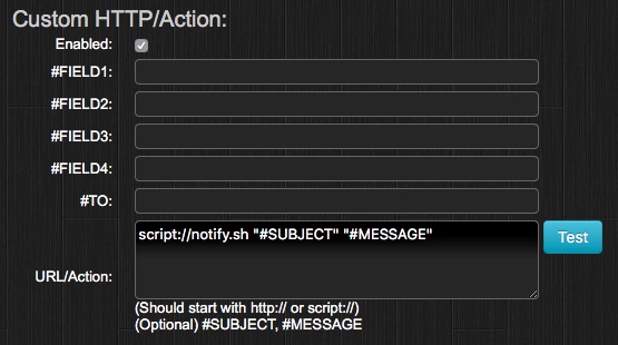

Ofcourse this is maybe better:
notify.sh
#!/bin/bash
osascript ~/Smarthome/domoticz/scripts/imessage.scpt "$1" "Subject: $2"
osascript ~/Smarthome/domoticz/scripts/imessage.scpt "$1" "$3"
With: script://notify.sh "[email protected]" "#SUBJECT" "#MESSAGE"
For config sake... rum...

In the custom message area of notifications on a switch I have this for "On":
script://notify.sh  "Hello" "World"
Nothing happens when the switch is turned on...Can somebody explain exactly how to get this set up?
