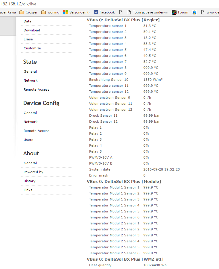

Last week I bought a Resol KM2 module url: http://www.resol.de/index/produktdetail ... sprache/en.
When i login through the web interface of the KM2, i cannot see the values (like posting Sandman79). When i login though vbus.net i can see this values, but seen no options for JSON. Can somebody help me?

i have connection to the datalogger
but i face problems with coding below
2017-04-01 20:24:19.676 LUA: ========================================================================================================
2017-04-01 20:24:19.676 LUA: Getting Resol DL2 Data
2017-04-01 20:24:21.134 Error: EventSystem: in script_time_boilertemp: /home/pi/domoticz/scripts/lua/json.lua:685: HTML passed to JSON:decode():
2017-04-01 20:23:55.065 Error: Webserver: File '/stylesheets/smoothness/jquery-ui-1.10.3.custom.css': No such file or directory (2)
2017-04-01 20:23:55.066 Error: Webserver: File '/stylesheets/RESOL/style.css': No such file or directory (2)
2017-04-01 20:23:55.068 Error: Webserver: File '/javascripts/jquery-1.10.1.js': No such file or directory (2)
2017-04-01 20:23:55.119 Error: Webserver: File '/stylesheets/smoothness/jquery-ui-1.10.3.custom.css': No such file or directory (2)
2017-04-01 20:23:55.120 Error: Webserver: File '/stylesheets/RESOL/style.css': No such file or directory (2)
2017-04-01 20:23:55.121 Error: Webserver: File '/javascripts/jquery-1.10.1.js': No such file or directory (2)
2017-04-01 20:24:01.082 Error: EventSystem: in script_time_boilertemp: /home/pi/domoticz/scripts/lua/json.lua:685: HTML passed to JSON:decode():
anybody any solution ?

Re: Resol DL2 Datalogger(Vbus)
Post by MarceldeJongNL »
When you open the page: http://<DL Ipadres>/dlx/download/live in browser, what do you get?
My result is:

			"unit" : "",
			"unit_code" : "None"
			"id" : "022_2_0",
			"name" : "System time",
			"unit" : "",
			"id" : "020_1_1",
			"name" : "Sensor 1 defective",
			"unit" : "",
			"id" : "020_1_2",
			"name" : "Sensor 2 defective",
			"unit" : "",
			"id" : "020_1_4",
			"name" : "Sensor 3 defective",
			"unit" : "",
			"id" : "020_1_8",
			"name" : "Sensor 4 defective",
			"unit" : "",
			"id" : "024_4_0",
			"name" : "Status mask",
			"unit" : "",
			"id" : "028_4_0",
			"name" : "Heat quantity",
			"unit" : " Wh",
			"unit_code" : "WattHours"
			"id" : "032_2_0",
			"name" : "SV Version",
			"unit" : "",
		"id" : "00_0015_2211_0100",
		"description" : "VBus 0: DeltaSol CS Plus => Standard-Infos",
		"channel" : 0,
		"destination_address" : 21,
		"source_address" : 8721,
		"protocol_version" : 16,
		"command" : 256,
		"info" : 0,
		"destination_name" : "Standard-Infos",
		"source_name" : "DeltaSol CS Plus",
		"fields" : [
	"headerset_stats" : {
		"headerset_count" : 1,
		"min_timestamp" : 1491424375.784000,
		"max_timestamp" : 1491424375.784000
	"headersets" : [
		"timestamp" : 1491424375.784000,
		"packets" : [
			"header_index" : 0,
			"timestamp" : 1491424374.894000,
			"field_values" : [
				"field_index" : 0,
				"raw_value" : 18.900000,
				"value" : "18.9"
				"field_index" : 1,
				"raw_value" : 33.300000,
				"value" : "33.3"
				"field_index" : 2,
				"raw_value" : 43.400000,
				"value" : "43.4"
				"field_index" : 3,
				"raw_value" : 23.300000,
				"value" : "23.3"
				"field_index" : 4,
				"raw_value" : 0.000000,
				"value" : "0"
				"field_index" : 5,
				"value" : "0"
				"field_index" : 6,
				"raw_value" : 1619.000000,
				"value" : "1619"
				"field_index" : 7,
				"value" : "0"
				"field_index" : 8,
				"raw_value" : 11.000000,
				"value" : "11"
				"field_index" : 9,
				"raw_value" : 1.000000,
				"value" : "1"
				"field_index" : 10,
				"value" : "0"
				"field_index" : 11,
				"raw_value" : 1354.000000,
				"value" : "22:34"
				"field_index" : 12,
				"value" : "0"
				"field_index" : 13,
				"value" : "0"
				"field_index" : 14,
				"value" : "0"
				"field_index" : 15,
				"value" : "0"
				"field_index" : 16,
				"value" : "0"
				"field_index" : 17,
				"value" : "0"
				"field_index" : 18,
				"raw_value" : 1.110000,
				"value" : "1.11"
			"header_index" : 1,
			"timestamp" : 1491424375.284000,
			"field_values" : [
That is where my script is based on.
