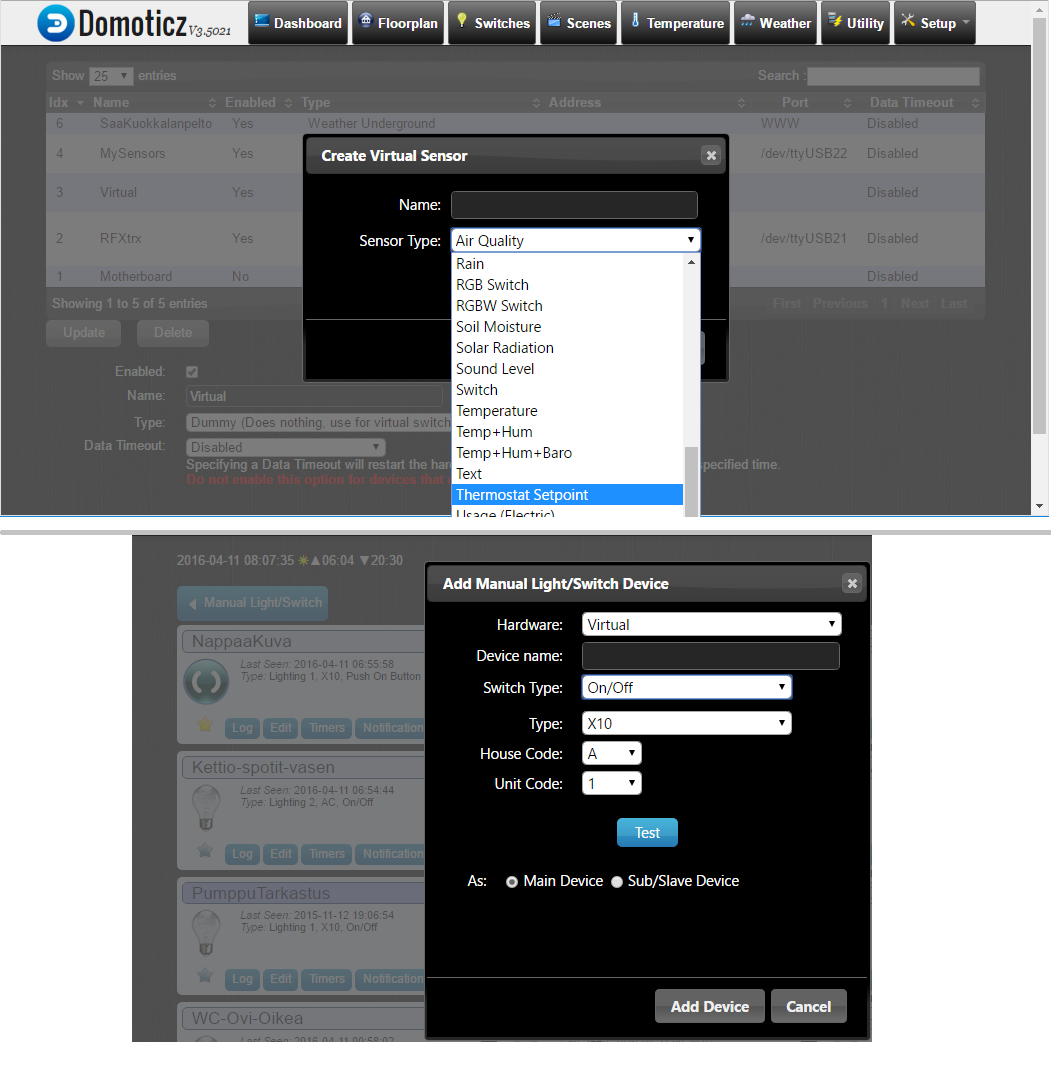

For more info about selector device see: viewtopic.php?f=31&t=7244
This is your device vs. domoticz type mapping:
- mode -> selector
- temperature -> temperature
- fan speed -> selector
- pan mode -> selector
- on/off -> on/off (see pic below)
If you need setpoint device(thermostat) there is where from you can find it:
LXC(x64 Ubuntu Xenial), RFXtrx433E, MySensors
