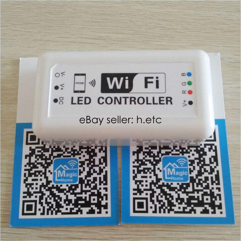

I have purchased a couple of WiFi RGB controllers. They use esp8266 with three mosfets(?) for each of the channels. I have spent the past 3 days googling around and running wire shark and packet capture on my android tablet. The app from Google play works fine with it and I'd now like to integrate it into Domoticz.
Despite all the hunting around I have not yet found a way to control it from Domoticz - Firstly, is there a device compatible with this creature or, secondly, has anybody got any pointers to where I might start to incorporate it. The pictures below illustrate the controller and it looks like a range of similar controllers from other sources.
Any help will be very much appreciated.
