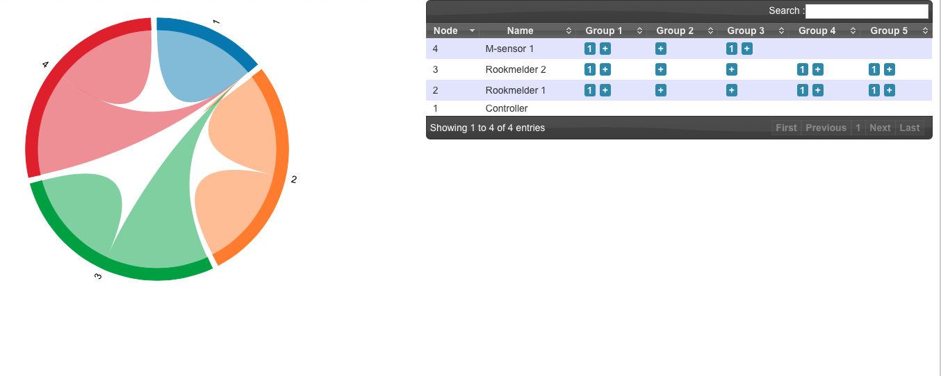

Here is a screenshot of my z-wave network.
Schermafbeelding 2016-04-05 om 12.36.35.png (81.59 KiB) Viewed 744 times

In general battery powered devices will go into a sleep and will not act as router in a Z-wave network.
You probably need a couple of powered devices to build a stable zwave mesh network.
