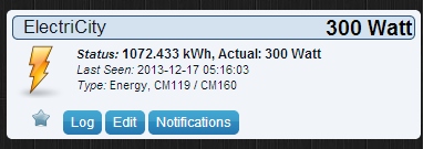

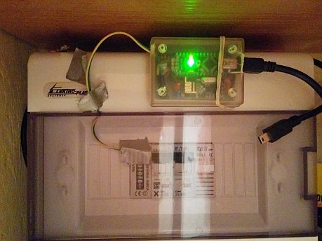

I've made myself an API between my own counter (with eeprom, it reads current Watt usage and also is relevant of the counter visible in front).
My API from MEGA is uploading the value of the meter to the Domoticz, but I don't think that values are ok.
Currently it gets: ex. 400W and 1072.3178 kWh (total usage).
But in Domoticz i only see 1.072 for CM119/CM160 sensor.
What data should I provide then?
Wouldn't it be better to let users customize data sources a little?
ATM I have to multiply everything by 1000 to see the difference.
-- EDIT:
Okay, I can answer myself once again on this forum... ;-)
The problem was that I was sending xxxx.yyyy value multiplied by 1000, so it was received as: xxxxxx.yy00.
I've managed to cut decimal places for 2 only and now it works:
Regards!
properly shown
