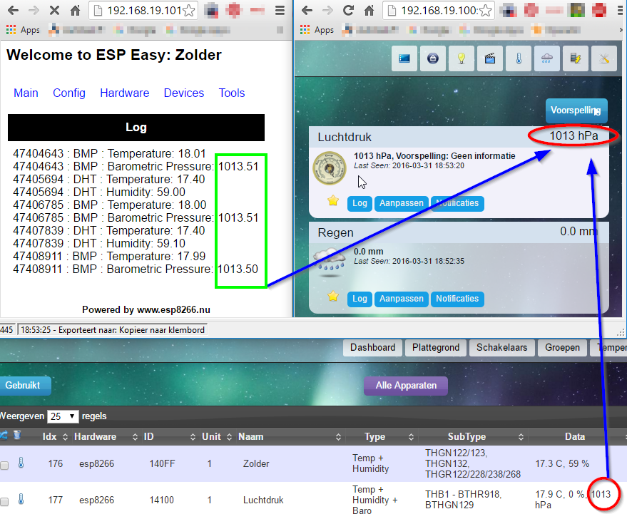

For example the esp8266 log shows an pressure of 1013,51hPa, Domoticz hardware shows 1013 with steps of 1 hPa. Which setting I'm missing
Decimals missing esp8266 nodemcu, bmp180 en domoticz
I'm using an esp8266 nodemcu and bmp180 for de presure in domoticz, and missing some decimals.
- 2016-03-31 19_02_54-Store.png (366.74 KiB) Viewed 1487 times

Re: Decimals missing esp8266 nodemcu, bmp180 en domoticz
maybe atmospheric pressure under 1 hPa is not really significant.
10 m water column = 1000 hPa
=> 1 cm water column = 1 hPa
=> 0,1 cm (1 mm) water column = 0.1 hPa -- is it really significant ?
It provides a streamlined graph rather than a blocky per 1hPa, thats why I now moved the bmp180 directly to the Pi instead of using it on the esp8266.
