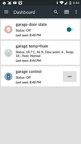

I'm very new with this software and I'm not good with codding very much. I Made myself a garage door oppener using espeasy, a relay board, a magnetic switch and a dht22. It's working very well. The only small snag I have is that I have to use two different swith, one on/off for the state of the door and an other push button (http://<ESP IP address>/control?cmd=Pulse,2,1,500) to pulse the relay to open and close the door.
When I tried to combine the two switch in one ON/OFF switch (both command are a pulse) it dosent work. The state of the switch dosent get updated and domoticz isnt in sync whith the module anymore.
The toggle in domoticz move each time I click the switch but is not connecteded to the mag switch anymore.
Is there a way to make the toggle of the switch in domoticz only move when the magnetic switch change state?
Forgive me if this is a common question I dident found any thing in on this subject.
I also joined a screen shot to ilustrate my point.

Re: garage door openner espeasy button update
I'm also looking for this option to control my garage door.
you can add a on command as script and also a off command. and then set a off delay by the on button.
so when you switch it on it automaticly goes of after 1 sec.
which realy/esp do you use? can you post pictures how you connect it to the motor?
