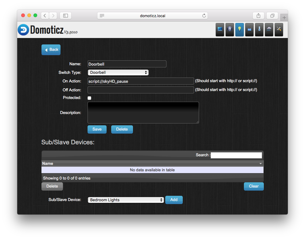

I have a simple script that runs when my doorbell is pressed, but for the reason I want it, it's taking too long until it fires.

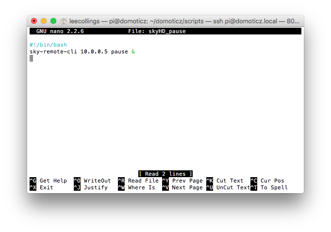

It's a simple script that sends a Pause command to my Sky HD box so that the TV is paused when the doorbell is pressed.
At the moment, it's just entered in the 'Script On' field when editing the doorbell switch.
And the contents of the script file look like this
In the log, the script is taking about 4-5 seconds until it fires, leaving the Skybox to pause when the doorbell sound has pretty much finished.
Is this natural behaviour of the 'On Script'? any ideas maybe with the contents of the script file?

Re: 'On Script' taking a bit too long to fire
Do you have other events being triggered by the change state of the doorbell switch?
For example: All script_device_xxx.lua are ran each time a device changes state.
Jos
Jos
Nope, well not that I'm aware of. This is the only script I have, there are no scripts in blocky or anything else. I literally only have this doorbell, some weather station data, and one light switch set up at the moment.
So I don't think, it's like an overloading of anything.
Running on a Raspberry Pi also
