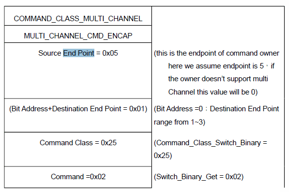

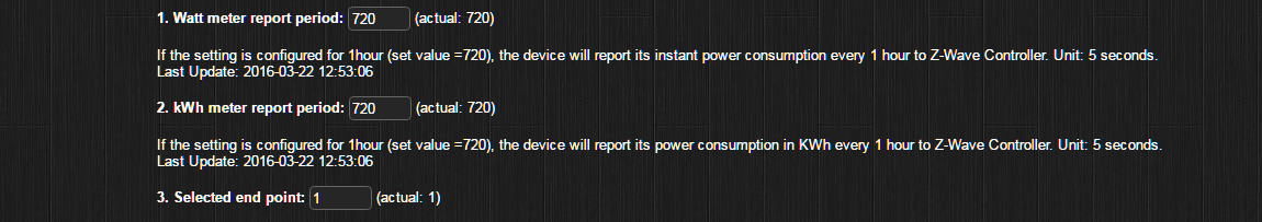

Hello, well it appears in manuals of domotic devices. For instance this images, but it appears in manuals and guides of paramters for setting devices.
This is from philio config page
This is from a philio PAN04  manual
