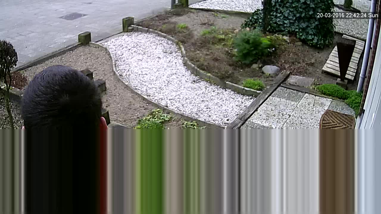

I use this script on my rasp. with a EScam qwl qd100
Because its only send out with rtsp en not with a JPEG url I need to use this to get an images if some-one calls on the door.
But the images are 9 of 10 with lines. like showed on the images below. Someone have an Ideas to fix this?

might have something to do with your camera. I have 2 ESCAM Snail QD500 cameras and 1 has the same issue as you describe whilst the other is working perfectly fine.
Btw maybe Robin Thicke based his song blurred lines on this camera? ;-)

I also have a ESCAM QD500 and depending on the firmware version you could try to capture the snapshot by accessing this undocumented url:
http://192.168.xx.xx/webcapture.jpg?com ... &channel=1
This will show the low res jpeg.
You can add this native in domoticz for snapshot o live feed.
