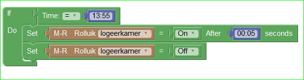

@ all
I'd like to close a blind somewhere halfway, depending a specific circumstance or at a specific moment. As I do not know how to do this in Lua I'd wanted to do this in blocky. I used the setup shown in the attachment. Unfortunately the blinds go fully down and doesn't stop after 5 sec.
The only thing I'd like to do is starting closing the blinds and after 5 seconds the motor should stop so the blinds are partly closed. When I do this by hand, this works perfectly.
What am I doing wrong?

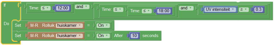

I played a bit with a UV sensor in combination with my previous blocky scenario but unfortunately did doesn't work.
What I would like is the following.
Depending the amount of UV, for instance more then 0.3, and the time is between 12:00am and 06:00PM the blinds should go down for about 50%. The % has been taken care of by the number of seconds after the second 'on' command. In case the sun goes down for about 5 minutes, nothing should happen. In case the sun goes down for let's say 15 minutes, the blinds should go up again.
To do this I thought I just have to read the value of the UV sensor which is the criterium for going down and adding some time limits. Unfortunately I didn't succeed in doing this properly.
To prevent, that the blinds continuous go up and down again there should also be a way which I do not know.
It appears that I still have much to learn concerning blocky. ;)
Who can assist me how to do this in blocky?

This is how I did it, hoping this would work.

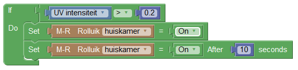

Meanwhile this blocky works partly. The blinds go down at the desired level, but after a few minutes, the action is repeated so after three cycles, the blinds are completely down.
Can anyone assist me how to prevent that the blinds go fully down and go fully up at a certain time?

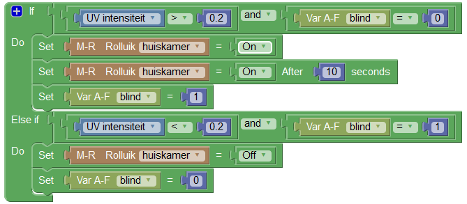

How about:-
If [UV] > 0.2 And User Variable = 0
Do Set Device = On
Set Device = On After 10 seconds
Set User Variable = 1
Else If [UV] < 0.1 And User Variable = 1
Set Device = Off
Set User Variable = 0
Just using a variable to stop the loop. (Also a 0.1 "Dead Band" to prevent rapid cycling.)
Worth a try? :)

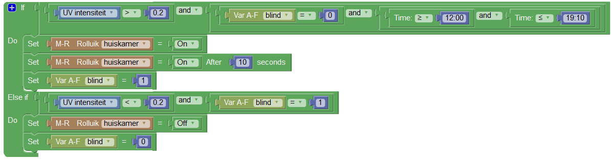

I made the following changes. I added the user variable which initially is 0.
If I understand it right the first loop checks the variable which has been changed from 0 to 1. So no second action is initiated.
As soon as the UV value has decreased below 0.2 the blinds will go up. At least that's how it looks to me.
This, I don't understand how I should create the delay.

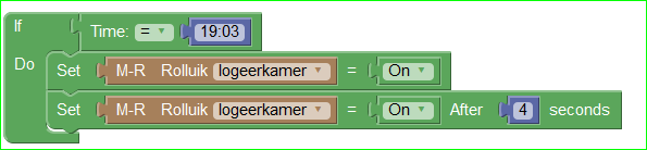

Meanwhile I added a timetable during which the action should take place. That's the time the sun really gets annoying when it shines on my flatscreen. ;)
I think it looks ok to simulate that I'm home as I'm actually away from home.
