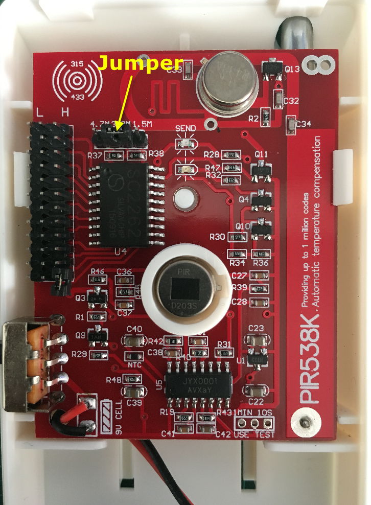

I also bought from this seller, I asked a 433MHz version with a sc2262 chip.
http://nl.aliexpress.com/item/Free-Ship ... 07324.html
the device presents itself in Domoticz as "Lightning 4" and "PT2262" and works perfect.
i did not use the L H pins (adresses) on the leftside of the board, only a jumper for frequency selection.

You have the option to receive this sensor as ARC sensor if you configure L H
See
http://www.domoticz.com/forum/viewtopic ... 44&p=72133
