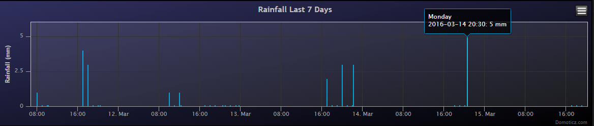

And this is the graph for same data
It shows that I have been starting the car 5 times between 13/3 ~23.00 until 14/3 20.30, but actually it was o the 15/3.
I know that there is no time stamp for exact date and time but if I send the value 5 at 2016-03-15 16:20 it shall not show 2016-03-14 20:30, or?

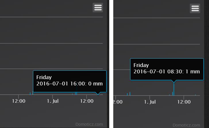

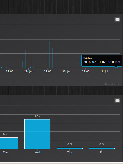

this is from my Rain sensor
2016-07-01 06:45 it reported 20.7 as VAR1 but I dont get any Rain, it should show 0.2
2016-07-01 07:55 it reported 21.0 and it got 0.3mm of Rain but it should be 0.5mm
I am reporting batterylevel every 2 hours and Rain is only reported when the bucket has tipped.

Did a test when I came home.
Time was about 15:45 and then I tipped the bucket manually 4 times, each tip is 0.25mm

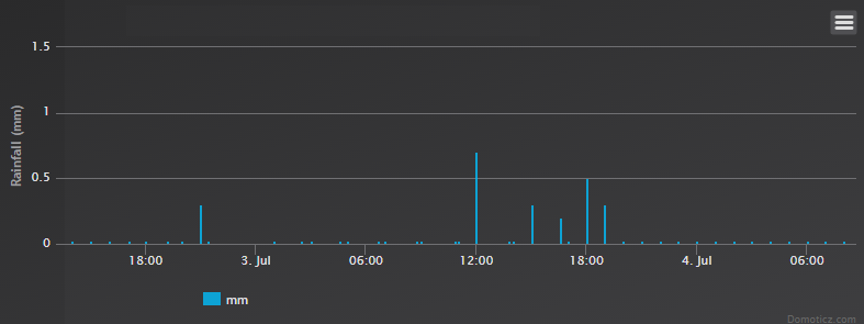

Now I am sure that it has something with the "Sensor Timeout" function to do.
3 July I change timeout from 70 minutes to 130 minutes and after that change graph looks much better.
Node are sending data when bucket tipped or 120 minutes and if timeout in Domoticz is lower than that it seems to not create Bars in graph
