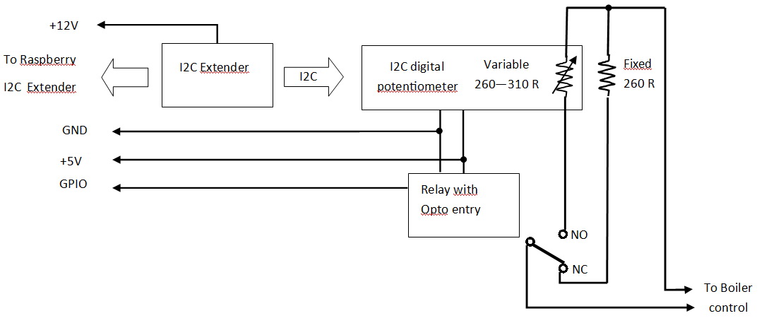

For point 2, I made it simple in the post, but the setup is a bit more complicated than a simple relay. The Viessmann Duomatik boiler controller (1997 model) reads the value of a resistor to set hot water temperature. So I have built an I2C digital Potentiometer I control with a Domoticz Slider switch (Consigne Chaudiere - Off, 0-100%) and a LUA script sending commands over the bus. I can also set timers to control night/day heating or turn it down low when not at home.
Only big problem is if I loose power on the system 5V and 12V, the DigiPot goes to infinite value sending boiler to full blow !! That's the reason of the relay to provide a fixed value resistor (connected to NO) to the boiler controller to keep in a low heat mode.
For this to work, I need to activate the relay and have a 1 (Chauffage marche - Switch On) on GPIO port while Domoticz is powered on.
Putting the -script option in the startup of Domoticz makes it run on every (re)start of Domoticz, not just on reboot (like with a cron script)
