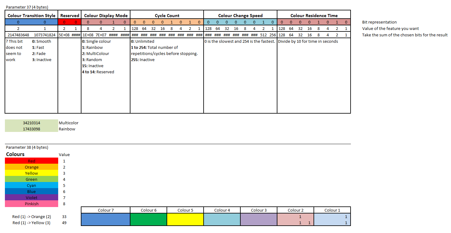

It took me a whole evening to figure out how to get the Aeotec LED Bulb Advanced Features working.
After googling for information I had to conclude that there is no tutorial for this and so I figured it out and write this manual to help others.

After reading the Aeotec LED Bulb manual it became clear that it is possible to send a command to the bulb and have it do the flashing itself.

As a java Software Developer I do understand binary so I started to read the manual. Soon I concluded it wasn't easy for me to do.
As stubborn as I am I started working on this puzzle and put all my findings in an excel sheet.
Results
The easiest was to create a picture of the excel sheet I created.
The excel shown in the picture is attached to the post.
In order to read this excel you do need a bit of binary knowledge.
Aeotec LED Bulb Advanced Functions.png (39.69 KiB) Viewed 796 times
