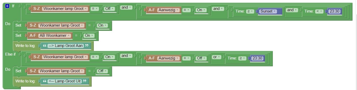

This is my first post to the forum, been reading until now.
I made the following event.
If we are home the light goes on between a set time and the light goes off after set time or if we are away.
Now i want to also use the remote "AB Woonkamer" to switch off the light.
But if i put the remote in the section "aanwezig=off" or "time>23:30" it goes straight on because of the first line.
Can anyone point me in the right direction ?
