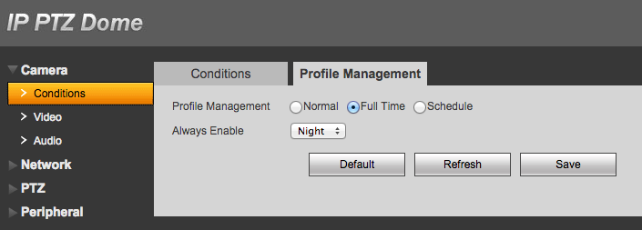

took me a good while to figure this out, so I am posting this up here for anyone searching in the future.
First setup your camera to be in Full Time profile for Day (or Night) since you will be changing it externally now.
Screen Shot 2016-02-16 at 4.18.33 AM.png (33.44 KiB) Viewed 2271 times
