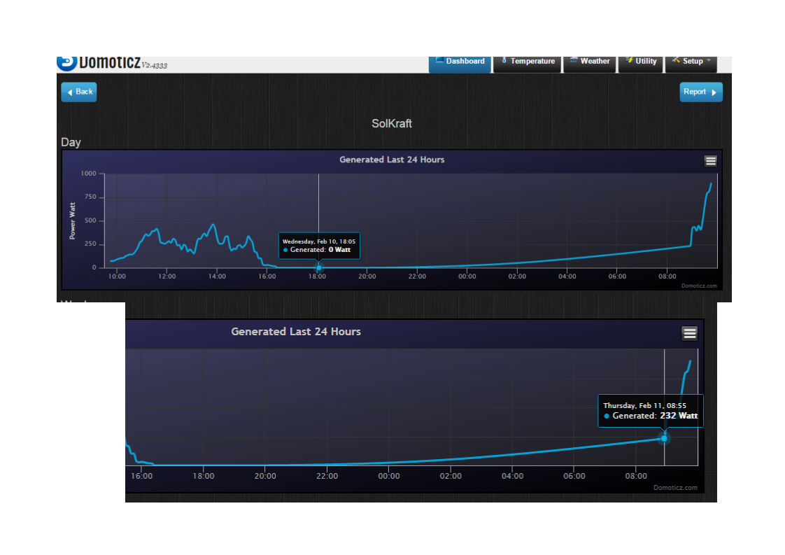

Thanks to this great forum and the awesome dwellers within I was able to relatively easilly setup my own system at home, consisting of a 1wire temperature newtork and a SBFspot-based Solar Inverter reader.
Now, as I hinted, this works fine - apart from a cosmetic point regarding the "Generated Last 24 Hours" graph.
Is there a way to disable the "smoothing" that takes place when the graph is generated?
Since no measurements are dune during nighttime, Domoticz creates a smooth curve between the last registered points, which looks odd.
I put a workaround in place today, by forcing measurements even during the night, but ideally I would simply like the curve to treat null/missing values as zero.
Graph Smoothing

i think this happens because there is no short-log value stored when it did not receive any update
there are two solutions:
#1
- in the sbfspot class when there is no new data, send 0 as usage with the last counter
#2
fix it in the general function that adds a shortlog value
void CSQLHelper::UpdateMeter()
//do not include sensors that have no reading within an hour
void CSQLHelper::UpdateMultiMeter()
could you try (for the test), go to the settings/other, for sensor timeout (default 60), set this to 1440 (1 day),
this might solve this problem because #2 is using this value
