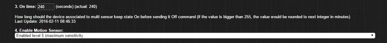

When saving my node configurations, what values does the dropdown send? As i can imagine it won't send "disabled/enabled".
In my screenshot I expect parameter 3 to send a "240" value. But what does parameter 4 send?

I figured it out.
So for anyone else having this problem...
setConfigParam(1, 23, 2, 0);
setConfigParam(1, 23, 3, 240);
setConfigParam(1, 23, 4, 5);
setConfigParam(1, 23, 5, 1);
setConfigParam(1, 23, 9, 0);
setConfigParam(1, 23, 39, 20);
setConfigParam(1, 23, 40, 0);
setConfigParam(1, 23, 41, 20);
setConfigParam(1, 23, 42, 10);
setConfigParam(1, 23, 43, 100);
setConfigParam(1, 23, 44, 10);
setConfigParam(1, 23, 45, 2);
setConfigParam(1, 23, 46, 0);
setConfigParam(1, 23, 48, 1);
setConfigParam(1, 23, 101, 241);
setConfigParam(1, 23, 102, 0);
setConfigParam(1, 23, 103, 0);
setConfigParam(1, 23, 111, 30);
setConfigParam(1, 23, 112, 30);
setConfigParam(1, 23, 113, 30);
setConfigParam(1, 23, 201, 0);
setConfigParam(1, 23, 202, 0);
setConfigParam(1, 23, 203, 0);
setConfigParam(1, 23, 204, 0);
setConfigParam(1, 23, 252, 0);
setConfigParam(1, 23, 2000, 240);
0 = disabled
1 = enabled
And for parameter 5 its
0 = disabled
1 = enabled low sensitivity
2 = enabled
3 = enabled
4 = enabled
5 = enabled highest sensitivity
(each level will rise the sensitivity)
