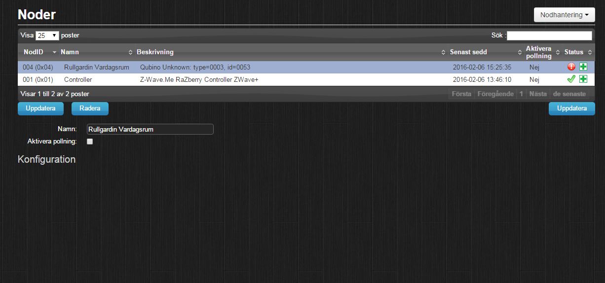

Hi. I'm new to RaZberry and I'm not sure that the chip is working. I'm having issues adding devices.
I installed it using the guide at: http://www.vesternet.com/resources/appl ... es/apnt-85
I tried two devices, one was never detected and one was added with an issue at the "status" (see attached picture)
I guess the second line "Z-Wave.Me Razberry Controller ZWave+" is the actual RaZberry chip.
Any log file that can give me the answer? I looked at /var/log/z-way-server.log but it doesn't say much..
Any help is appreciated!!
/Magnus

This should be moved to the zwave topic (domoticz is starting here)
You have a quibino device that is not recognized yet by openzwave, or you are not running the beta release of domoticz
Sometimes when a sensor is not recognized, you can still operate it.
What type it is ? Sometimes you can modify the Config/manufactorer_specific.xml file, and use another quibino devices as start
(and exclude/include the sensor again)

I'm running Domoticz 2.3530, should I go for a beta?
I think I'm supposed to be able to set some properties for the device (when I click the line, see my old picture) but nothing
It's a Qubino Flush Shutter DC : https://www.m.nu/flush-shutter-gen5-qubino-p-2299.html
Where do I find the .xml files on the Raspberry? As I said I'm new to RazBerry AND z-wave..
Thanks for engaging!

I upgraded to the latest beta and now it's detected fine.
I think I'm fine now. Probably I will have other problem later...
