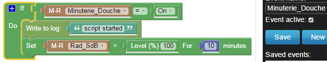

I thus created another dummy device and a lightswitch (named Minuterie_Douche (=timer..), where I set "Off Delay" at 10 minutes, and I created a bockly event so that when I set the Minuterie to ON, the blockly event should set the heater switch to 100% (and to 0% when the Minuterie goes back to OFF automatically).
Unfortunately, it's not working : when I click on the logo of the Minuterie Switch, that switches changes its status, but the blockly event does not seem to start: in the log, I can see the status change of Minuterie, but I don't see any change on my heater switch and I don't see the message I try to write in the log.
Here's a my Blockly event (restricted to switching ON the heater (through settign level at 100%) and writing to the log)
03-02-2016 12-01-24.png (29.05 KiB) Viewed 2004 times
What am I doing wrong ? Why is Blockly event not starting when I push my Minuterie button ?

Ricorico94,
if you use IF block without ELSE,
then use the IF block without the + sign

Post by ricorico94 »
Hi Domosapiens,
To be honest, I think I had tried with and without.. but I tested again without block ELSE, and it seems working. Maybe it was the issue. Blockly is so sensitive ?
