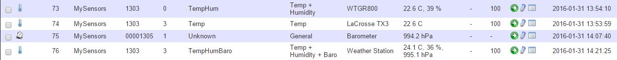

I have weather station with BMP180 and SHT21D sensors connected to Ceech Arduino board. It's presented in Domoticz (2.3530).
Today I found, that when the pressure was below 995 hPa sensor is not updating in Domoticz. When i delete it from devices list, it's even cannot be found. It's recognized as Unknown, General, Barometer.
When the pressure increase over 995 then sensor is recognized correctly (as TempHumBaro, Temp+Humidity+Baro, Weather Station) and it's updated.

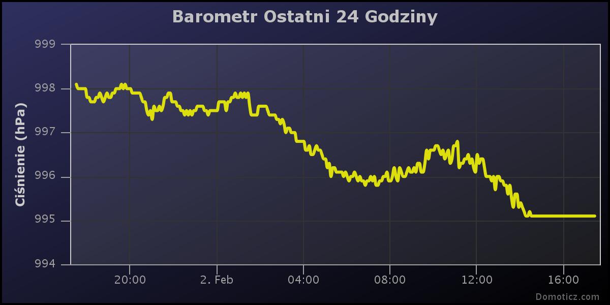

well i tryied send fixed vaules in mysensor sketch. If P <995 all sensors are not update. When if P>995 sensors are updated.
This is my code:
gw.send(humidityMsg.set(SHT2x.GetHumidity(), 2)); // Send Humidity
gw.send(temperatureMsg.set(SHT2x.GetTemperature(), 2)); // Send Temperature
gw.send(pressureMsg.set(P, 1)); // Send Pressure

gizmocuz
Posts: 3026
Location: Top of the world
Re: Pressure BMP180 <995 hPa not updated
Post by gizmocuz »
Thanks for the test, i found something here in the domoticz mysensors code (and bmp/netatmo)
There was a break line in the code that should not have been there.
Please try the new beta version #4388

Post by makuta77 »
Hi, nothing changed. Currently I updated to #4439 and i have the same situation: If preasurre <995 hPa Temp+Hum+Baro sensor stop updating.

Sorry, it was connection problem. Now it seems to work.
I will observe it closer. Thanks for your help!
