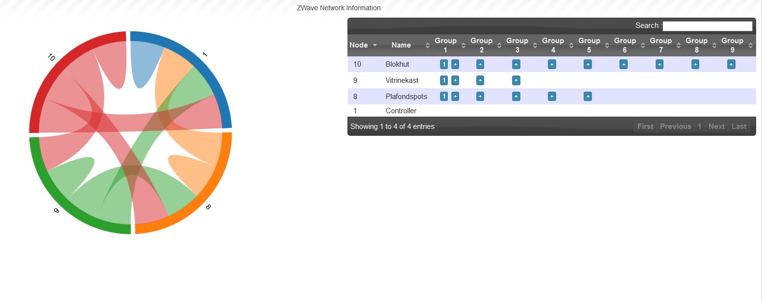

yes and i like to add that z-wave uses a meshing technology(it communicates through neighbours)
i had a module which was far away and could not be reached.
i had 2 other modules in the house but they were not aware of the module far away.
i took the module which was far away inside the house and the network instantly figured out al the connections to eachother.
after that i moved the module back and have no issues since
i have timeoutes on the network bu this is normal because i now have 3 routes to the module far away and if one of them is slow it will time out.
running for months now.
One word of caution.
If i would use the repair network option it will probably kill some routes.
better have more routes that sometimes are slow then only one.
Module 10 is the one far away.
The others are inside the house
- Naamloos.jpg (106.63 KiB) Viewed 6308 times
