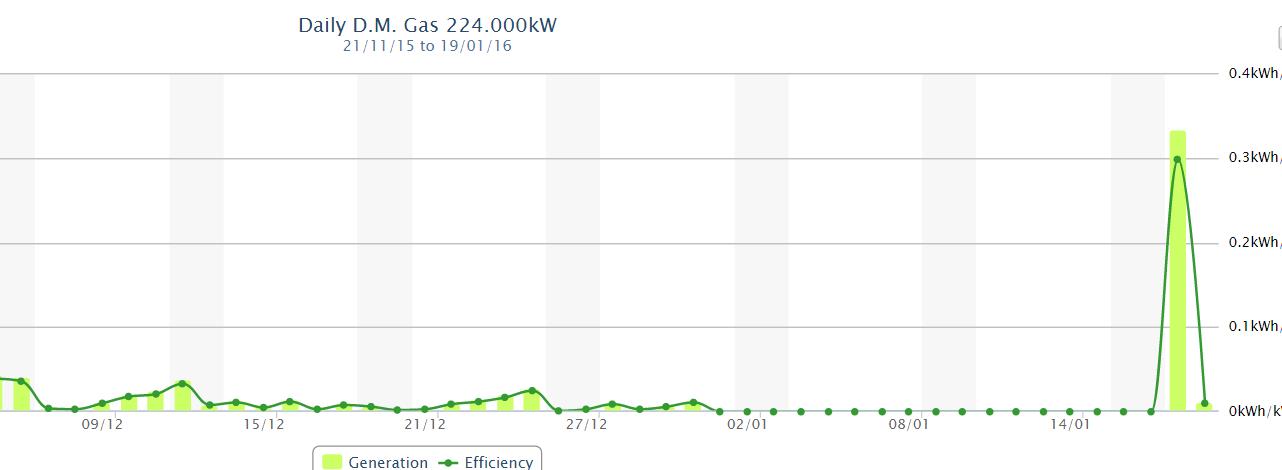

In fact, it has gotten a bit worse. The Power meter says it received the last data at 12:00 hrs today, almost 7 hours ago. But if I run cu as above, I get updates every 12 secs or so.
Does anyone know what could be going wrong here?

for the raspberry pi this is on explained on the wiki, but here it goes
In the settings, set the release channel to beta, then from the setup menu issue -> check for update
If that does not work
Login with SSH with the 'pi' user
cd domoticz
./updatebeta
cd domoticz
./updatebeta
