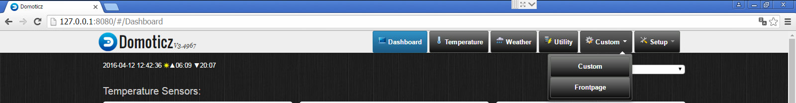

This is what I mean, I can choose from different Frontpage by clicking at Custom-tab, each choose is a HTML file in ...\www\templatesjannl wrote:Not sure what you mean, I also use both, depending on the url I get the correct data;
- http://ip:port/ -> gives default dashboard
- http://ip:port:/frontpage.html -> gives the forntpage data
Just make sure all files have different names, so nothing gets overwritten.
- domoticz4.png (129.75 KiB) Viewed 3406 times

Just add a HTML file with an iframe to the frontpage in the templates folder.Flopp wrote:This is what I mean, I can choose from different Frontpage by clicking at Custom-tab, each choose is a HTML file in ...\www\templatesjannl wrote:Not sure what you mean, I also use both, depending on the url I get the correct data;
I am using the following html
<html>
<head>
<div align="center">
<iframe src="http://<ip>/folder/frontpage.html" name="targetframe" allowTransparency="true" scrolling="no" frameborder="0" width="1024" height="748">
</iframe>
</div>
</head>
</html>
Not using Domoticz anymore
Flopp
- Posts: 279
- Joined: Sunday 03 January 2016 14:55
- Target OS: -
- Location: Sweden
Thank you now it works like I wantG3rard wrote:Just add a HTML file with an iframe to the frontpage in the templates folder.Flopp wrote:This is what I mean, I can choose from different Frontpage by clicking at Custom-tab, each choose is a HTML file in ...\www\templatesjannl wrote:Not sure what you mean, I also use both, depending on the url I get the correct data;
