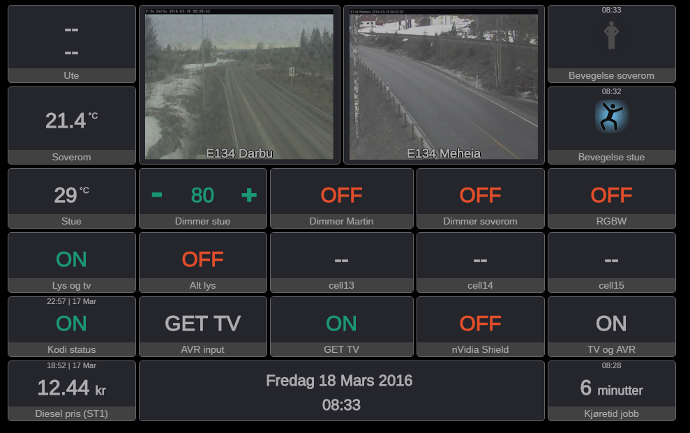

Im starting to get the status page like I want it:
But I would like to integrate "+ VOL -" into one cell, so when you press + it adjust volume up and the opposit for -. And pressing the VOL would toggle mute. Is this in any way possible? Below I have the curl commands. I could not figure out a good way to do this via Domoticz virtual switches.
Robert

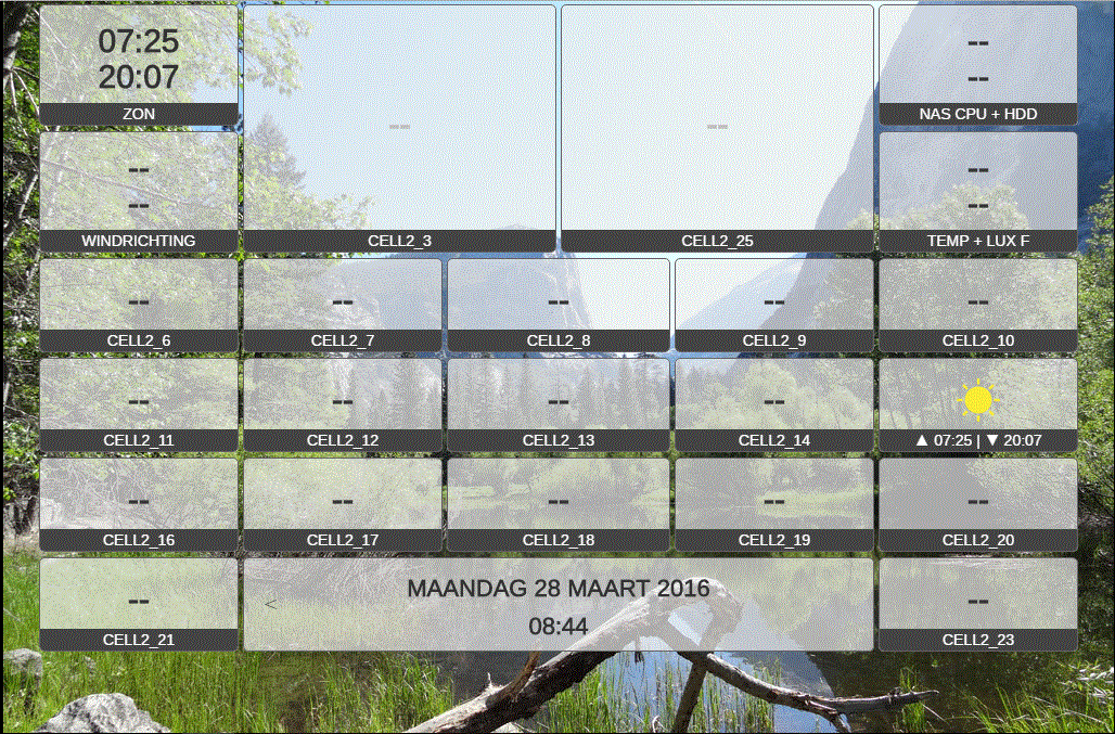

Edit: My frontpage shows this:
I created a roomplan (ID 2) and put al my devices in it.
This is my Domoticz temporaly setup Then i edited some of the pagearray's that i use, but still no data? The only data is time and sunset/sunrise.
I have basic authentication set, but also configured the local network.['31', 'Status', 'cell6', 'Printer', '1', '1'],
['41', 'Status', 'cell7', 'Printserver', '1', '1'],
['447', 'Temp', 'cell8', 'Woonkamer', '1', '0'],
['30', 'Status', 'cell9', 'Kodi-1','1','1'],
['44', 'Status', 'cell10', 'Kodi-2','1','1'],
When i change the IP address or portnumber i get the default nightscreen, so i know it has no connection.
I see there is a frontpage.html and index.html, and also a a frontpage_settings.js and a settings.js. So i both configured them.
The question is, why am i so stupid to get it working

On index.html i get
On frontpage.html i get
BTW i extracted all the files, and upload them in de WWW folder inside the folder 'Frontpage'
which is this lineUncaught ReferenceError: vdate is not defined frontpage.js 93
if (thisday == vdate) {Which is this linefrontpage.js:522 Uncaught ReferenceError: switchclick is not defined(anonymous function) @ frontpage.js:522
x.extend.each @ jquery.min.js:4
55c@ jquery.min.js:
4p.fireWith @ jquery.min.js:
4k @ jquery.min.js:
6r @ jquery.min.js:6
http://192.168.1.1/videostream.cgi?user ... d=password Failed to load resource: net::ERR_CONNECTION_TIMED_OUT
$('#' + vlabel).html( '<div ' + switchclick + ' style="' + vattr + ';' + alarmcss + '">' + vdata + vdataSuffix + '</div>');-
aiolos
- Posts: 127
- Joined: Sunday 13 September 2015 18:58
- Domoticz version: stable
- Location: Nieuwegein, NL
I think you have used some switch types I don't use and have not really tested in the refactoring of the whole js file.
I just committed some fixes (quite ugly by just adding the variables so they exist). Please pull/download the new version of frontpage.js.
