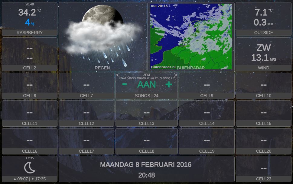

Posted: Sunday 06 March 2016 17:40
by SwordFish
Just playing with the frontpage :)
