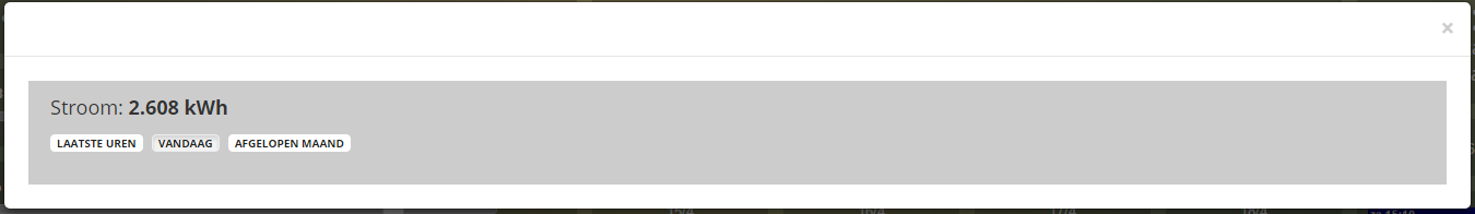

For current power usage, daily power usage and daily gas usage I get this as a result, probably not coded yet?
The first few tries I just got a Loading... screen.

SwordFish
Posts: 278
Domoticz version: V4.11375
Re: Dashticz v2.0, custom positioning and multiple screens
Post by SwordFish »
robgeerts wrote:
Dropshot wrote:Could it be possible to see the graps, of for instance the temperature, when I press on the block?
Please test this in latest version
Its not working for al the temperature, its only working for me on the motherboard temperature.
