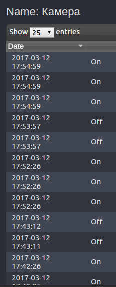

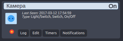

I have problems with Xiaomi Smart Socket (ZigBee). Domoticz v3.6908
Снимок экрана от 2017-03-12 17-55-28.png (14.4 KiB) Viewed 2777 times
Снимок экрана от 2017-03-12 17-57-20.png (37.57 KiB) Viewed 2777 times
2017-03-12 18:23:08.655 {"cmd":"heartbeat","model":"plug","sid":"158d00011016d0","short_id":41069,"data":"{\"status\":\"off\",\"inuse\":\"0\"}"}
2017-03-12 18:23:21.277 User: Admin initiated a switch command (9/Камера/On)
2017-03-12 18:23:21.353 (Xiaomi) Light/Switch (Камера)
2017-03-12 18:23:21.368 {"cmd":"report","model":"plug","sid":"158d00011016d0","short_id":41069,"data":"{\"status\":\"on\"}"}
2017-03-12 18:23:21.427 (Xiaomi) Light/Switch (Камера)
2017-03-12 18:23:21.456 (Xiaomi) Light/Switch (Камера)
2017-03-12 18:23:21.473 {"cmd":"report","model":"plug","sid":"158d00011016d0","short_id":41069,"data":"{\"status\":\"on\"}"}
2017-03-12 18:24:00.499 LUA: TV ping success
2017-03-12 18:24:00.626 LUA: TV says it is active
2017-03-12 18:24:00.626 LUA: TV active, status is ON, so do nothing.
2017-03-12 18:24:14.435 User: Admin initiated a switch command (9/Камера/Off)
2017-03-12 18:24:14.601 XiaomiGateway: not updating Domoticz for switch as no change from last state
2017-03-12 18:24:14.601 bIsOn = false
2017-03-12 18:24:14.601 nvalue = 0
2017-03-12 18:24:14.601 messagetype = report
2017-03-12 18:24:14.601 {"cmd":"report","model":"plug","sid":"158d00011016d0","short_id":41069,"data":"{\"status\":\"off\"}"}
2017-03-12 18:24:14.585 (Xiaomi) Light/Switch (Камера)
