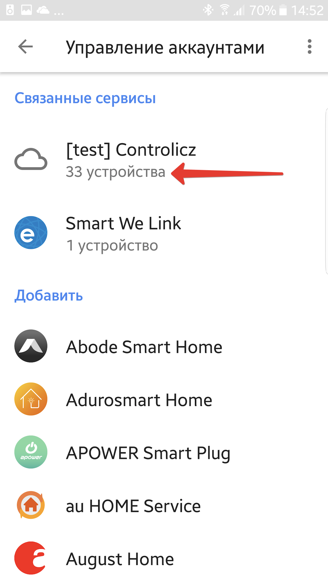

Madgeni wrote: Tuesday 30 January 2018 18:10 "sync my devices" will work
Works, but not quite right. The number of sensors / switches in Domoticz and Google Home does not match.
He also noticed that in Google Home there were scenes of Domoticz
See screenshots:
The attachment 2018-01-31_14-56-01.png is no longer available
The attachment 2018-01-31_14-58-04.png is no longer available
Madgeni
Posts: 1571
Re: Controlicz - Domoticz to Google Home/Assistant integration
Post by Madgeni »
Are those devices/scenes in room plans in Domoticz? If they are, they'll be in Controlicz, if they aren't, they won't
superustas
Posts: 15
Joined: Monday 29 January 2018 13:53
Post by superustas »
And again the advice helped - it worked :)
Thanks a lot, Madgeni!
