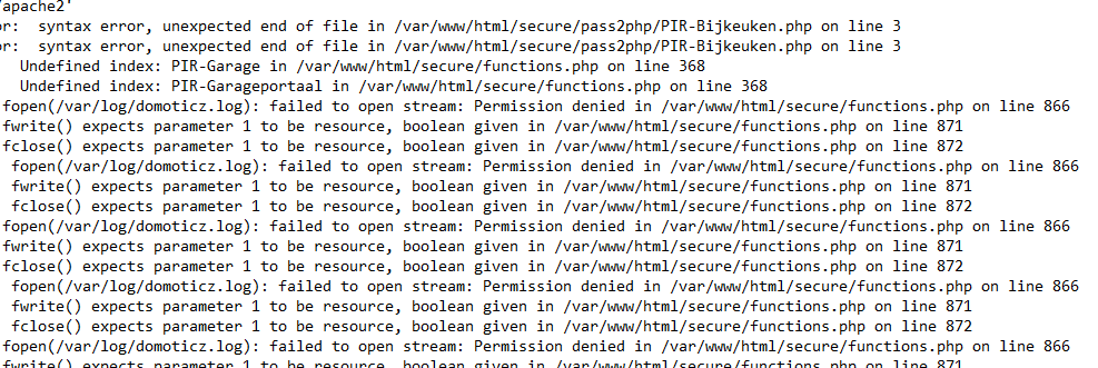

i did a tail -f on the apache error log
since i set a lg (‘test’) on the pass2php.php file i can the test line in the apache log

now when I trigger the motion sensor i get the following error. apperantly something is wrong with the scriptTrigun wrote: Saturday 04 May 2019 22:39ok, i did a chmod 777 on /var/log. now the error is gone.Trigun wrote: Saturday 04 May 2019 22:22yess I got something and it does show some errorssincze wrote: Saturday 04 May 2019 22:20 Normally Apache should have some logging.

Trigun wrote:now when I trigger the motion sensor i get the error that something is wrong in line 3 apperantly something is wrong with the scriptTrigun wrote: Saturday 04 May 2019 22:39ok, i did a chmod 777 on /var/log. now the error is gone.Trigun wrote: Saturday 04 May 2019 22:22 yess I got something and it does show some errors
2019-05-04 22_20_00-_var_log_apache2_error.log - Domoticz-NEW! - Editor - WinSCP.png
since i set a lg (‘test’) on the pass2php.php file i can the test line in the apache logbut I dont know what?

You are missing a closing bracket } in your script

Whaaaa great it works!!!sincze wrote:This website can check your php code and save you a lot of trouble

And issue the sw function but now off.
Dit you implement cron.sh the Domoticz monitor and also used for pass2php crons??
Look for an example with function past(60) in it.
