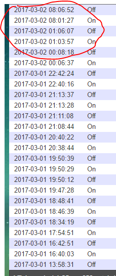

Don't know if this happens the same way to others, but I still get the door sensor open once in a while without the door is really open (sorry for my english!!!)
Now it happens exactly every hour.
I've tried to set the Xiaomi Gateway Data Timeout from Disabled to 30mins, but nothing changes.
Any suggestion?
Any suggestion on why it happens exactly every hour?

woody4165 wrote:Hi
Any suggestion?
Which FW did you have on your gateway ?
I'm with 1.4.1_143.0141 FW and i don't have this issue and Domoticz : Version: 3.6807
There is my log :

woody4165
Posts: 476
Joined: Monday 14 March 2016 13:55
Location: Rome, Italy
Post by woody4165 »
Hi deennoo
the gtw fw should be the same
Domoticz is on 3.6808
Here is the log with some time marked.
Strange thing is that some are On and some are Off.
PS: Just got another one while I'm writing, this time On.

woody4165 wrote:Hi
Any suggestion?
This problem came to me from version 3.6800

For the false door sensor readings, please post the log output from the same time, might shed some light on what is triggering it.

Regarding the false door sensor readings, starting with the new update, 3.6833, it seems that I don't get false notification.
I'll wait one or two days to get more data...

@woody4165, unless you are compiling my repo, nothing should be different with Domoticz? I did have a pull request in that was soon cancelled due to other issues.

corbin wrote:@woody4165, unless you are compiling my repo, nothing should be different with Domoticz? I did have a pull request in that was soon cancelled due to other issues.
That's weird! Just updating official beta... From this morning it's working fine, no false notification and notification when door is open.
