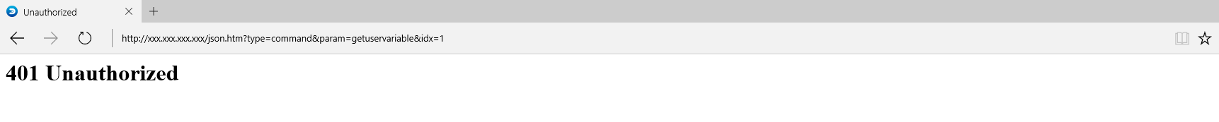

Can anyone help with this. A couple of days ago I installed the new TelegramBot from simonrg. Everything went very well and works fine now.
Now I tried to do the same for my parents, but the dtgbot doesn't start up. With the command: sudo service dtgbot start, it says: Starting Telegram....
But nothing happens. When I try: sudo service dtgbot status it says: dtgbot is not running.
This is my log fil:
/usr/bin/lua5.2: /home/pi/dtgbot/dtgbot.lua:291: bad argument #1 to 'lower' (string expected, got nil)
stack traceback:
	[C]: in function 'lower'
	/home/pi/dtgbot/dtgbot.lua:291: in function 'HandleCommand'
	/home/pi/dtgbot/dtgbot.lua:400: in function 'on_msg_receive'
	/home/pi/dtgbot/dtgbot.lua:490: in main chunk
	[C]: in ?
What went wrong? I can send messages to the id's with http, so my bot is working, only the dtgbot isn't.
Thnx!

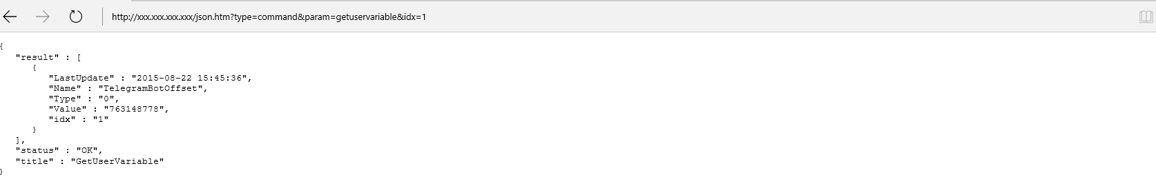

Edit1:
I think it does have something to do with authorization. Check both images. One of them is mine and one of them are my parents. I don't know in which authorization I have to look.
Edit2: I think it works now. The uservariable in domoticz was set on 1. When I changed it to 2 it started. After that I've got a lot of messages till it crashed again. I requested the latest integer uservariable and changed it 1 higher. After that it's still working. Hope for a long time!
Thnx for thinking. Maybe it was helpful to other people.

Slayer007 wrote:Yep! And tried to remove everything and start over, but that also doesn't work. :-(
Edit1:
The message shows unauthorized response from Domoticz, it looks like your Domoticz needs authentication, so not really a Telegram issue.
Which uservariable did you change?
