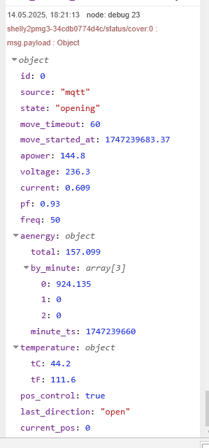

Could you remove the "Function" node, called "Blinds + Percentage" and replace it with this new "Function" node?
And test again and let me know.
Now everything works fine :) Great

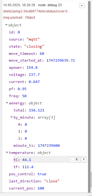

So, if this works, can you show me the debug output of the following flow, in all positions )Open. Close and a slider position)
Then I can implement that.

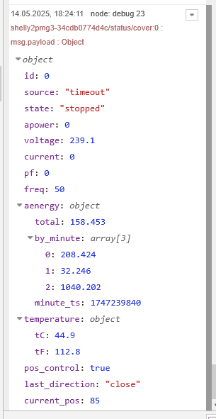

I added this flow in a new flow, I don't know if it's good but I think it's ok:
Data:
CLOSED:
OPEN:
15%:

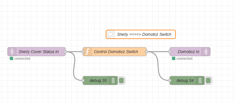

Hello @Daro1003,
I have created a flow for the Shelly to Domoticz.
It should update the Domoticz widget only. So it does not activate any actions, that you might have configured for the Switch.
See:

The only thing you have to do is to configure your own MQTT Settings
Can you test with your wall switch, that the indication on the widget is correct. And let me know.

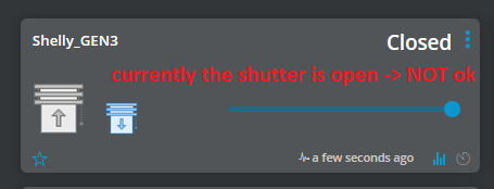

I improvised the flow - there is an immediate connection.
Unfortunately, when I click the switch on the wall it does not change the state of the switch in Domoticz.
After importing - I didn't change anything.
Where should I insert the Domoticz switch IDX?
Where do I insert the shelly ID?

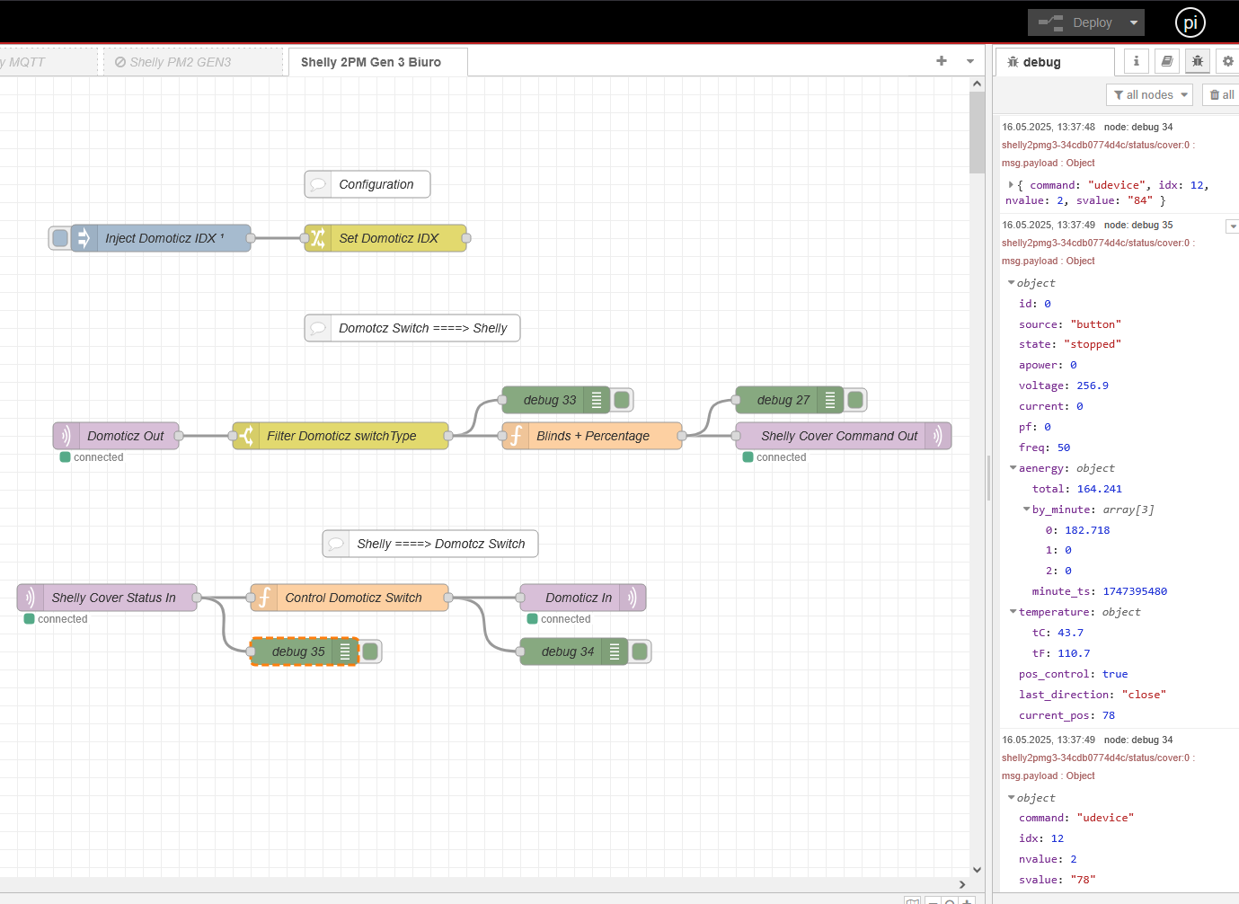

Debug nodes after pressing the key are active.
Slider in domoticz NO.

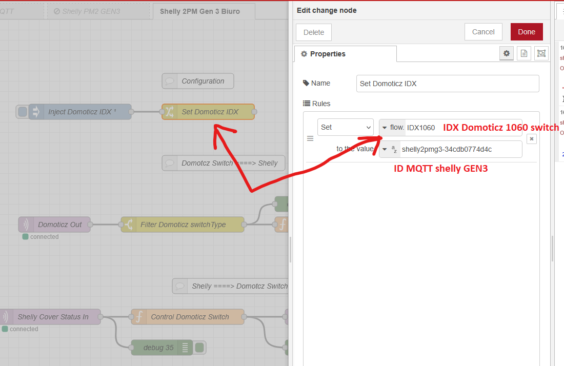

You still use my index number (12). See "Debug" node idx:12.
It is very unlikely that your Domoticz Switch (Blinds + Percentage) has also the Idx 12.
In my post, dated 12 May 2025, 18:46 , I wrote:
1. In the first stream, you have to configure the relationship between the Domoticz Switch index and the Shelly Client ID.
Open that "Change" node and edit the fields. a description is included in the "Comment" node, called "Configuration"
This has to done once for all "Blinds Percentage" Switches.
Did you ever do that? I don't think so.
If you follow the guideline in the "Comment" node, it should work.
It is very simple. Change IDX12 to IDXxxx, where xxx is the IDX number of your Domoticz switch.
Try it,

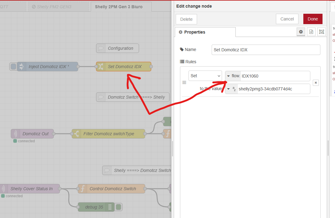

YES - s this the node:
My shelly switch idx is 1060
I have changed it.

Hi @Dare1003,
Yes, that is the one, that I mean.
Check it.
I have changed it.
And does it work now?

As the screen has, I had it set to my own id 1060 from the moment you sent this flow.
Currently, the slider from the local key does not work.
NO

I mean, if you push the button in Domoticz or move the slider, does the the Shelly still react?
The only setting, you have to make is the Change node and that is okay, as you showed me

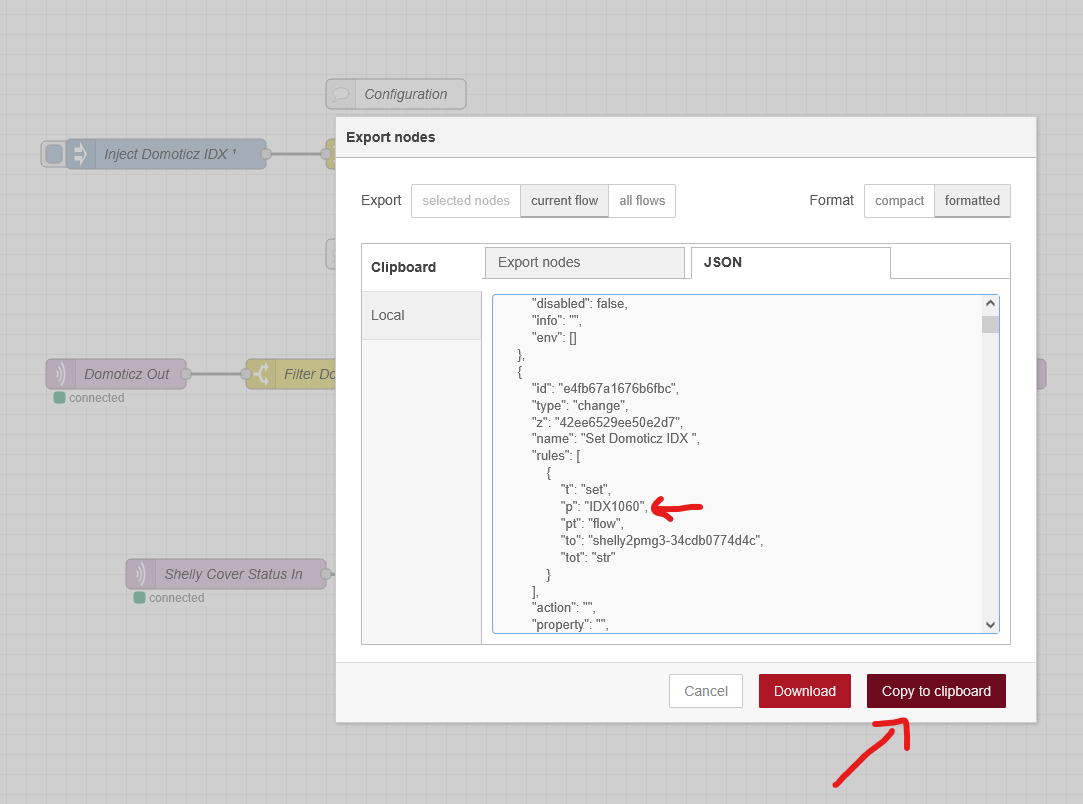

I change this setting and it still doesn't work.
YES
This is how the roller blind reacts and works.
Look:
Interestingly:
1. It gives an export of the entire flow:
        "id": "42ee6529ee50e2d7",
        "type": "tab",
        "label": "Shelly 2PM Gen 3",
        "disabled": false,
        "info": "",
        "env": []

As you can see, the IDX is already correct
2. I import and paste the code
3.
The % indicator works after using the button on the wall - great
Raising and lowering with buttons in domoticz works - Correct operation
The slider in domoticz works. Sets the blind in the appropriate position - Correct operation
Problem:
The indication of the open and closed position of the roller shutter is incorrect:
The inscription indicates the shutter is closed, while the shutter is open.
The slider indicates the shutter is closed, while the shutter is open.
Replacing the node function: "Blinds + Percentage" - nothing helps.
Yes, that is also the intention, but click on "Local".
In my post of 15 May 2025, 22:06 , I wrote:
1. Go to the "Hamburger" menu at the top right.
2. Select "Export".
3. You see the nodes, you are about to export. Select "Local".
4. In the field "Export as" give it any name you want, e.g. flows.shelly_2pmgen3 or whatever and you have saved it.
See point 3: Select "Local"
Problem:
I think you're close to getting this flow going.
Please can you replace the node, called "Control Domoticz Switch", with the following node.
        "id": "3be52bd193485cf4",
        "type": "function",
        "z": "589aa1f8113f3797",
        "name": "Control Domoticz Switch",
        "func": "let clientId = msg.topic. split (\"/\")[0];\n\nfor (let i = 0; i < flow.keys().length; i++) {\n\n    if (clientId === flow.get(flow.keys()[i])) {\n\n        let idx = parseInt(flow.keys()[i].substring(3));\n\n        //Open (for Reversed Position)\n        if (msg.payload.current_pos === 0) {\n            msg.payload = { \"command\": \"udevice\", \"idx\": idx, \"nvalue\": 1, \"svalue\": \"100\" }\n        }\n\n        //Closed (for Reversed Position)\n        if (msg.payload.current_pos === 100) {\n            msg.payload = { \"command\": \"udevice\", \"idx\": idx, \"nvalue\": 0, \"svalue\": \"0\" }\n        }\n\n        //Percentage (for Reversed Position)\n        if ((msg.payload.current_pos > 0) && (msg.payload.current_pos < 100)) {\n            msg.payload = { \"command\": \"udevice\", \"idx\": idx, \"nvalue\": 2, \"svalue\": msg.payload.current_pos.toString() }\n        }\n        return msg\n    }\n}\n",
        "outputs": 1,
        "timeout": 0,
        "noerr": 0,
        "initialize": "",
        "finalize": "",
        "libs": [],
        "x": 450,
        "y": 520,
        "wires": [
                "6b107f279c3940b6",
                "ad6d65a29fe88f81"
I think it should work.
Test it and let me know.

Then try this new "Function" node.
        "type": "function",
        "func": "let clientId = msg.topic. split (\"/\")[0];\n\nfor (let i = 0; i < flow.keys().length; i++) {\n\n    if (clientId === flow.get(flow.keys()[i])) {\n\n        let idx = parseInt(flow.keys()[i].substring(3));\n\n        //Open (for Reversed Position)\n        if (msg.payload.current_pos === 100) {\n            msg.payload = { \"command\": \"udevice\", \"idx\": idx, \"nvalue\": 1, \"svalue\": \"100\" }\n        }\n\n        //Closed (for Reversed Position)\n        if (msg.payload.current_pos === 0) {\n            msg.payload = { \"command\": \"udevice\", \"idx\": idx, \"nvalue\": 0, \"svalue\": \"0\" }\n        }\n\n        //Percentage (for Reversed Position)\n        if ((msg.payload.current_pos > 0) && (msg.payload.current_pos < 100)) {\n            msg.payload = { \"command\": \"udevice\", \"idx\": idx, \"nvalue\": 2, \"svalue\": msg.payload.current_pos.toString() }\n        }\n        return msg\n    }\n}\n",
        "outputs": 1,
        "timeout": 0,
        "noerr": 0,
        "initialize": "",
        "finalize": "",
        "libs": [],
        "x": 450,
        "y": 520,
        "wires": [
                "6b107f279c3940b6",
                "ad6d65a29fe88f81"
Let me know
Daro1003
Posts: 203
Joined: Monday 14 November 2022 12:46
Domoticz version: 2023.1
Location: Poland
Re: Is it possible to add Shelly 2PM GEN 3 to Domoticz?
Post by Daro1003 »
Działa odpowiednio cały przepływ.

I understand that for the next shelly driver I change the IDX and shelly ID as in the picture.
NO, ABSOLUTELY NOT
Never edit the visible text in the import or export function.
Work only on the canvas.
If you want to add another Shelly 2PM Gen 3 to the system, do the following
In Domoticz:
1. Create a new virtual Switch in Domoticz.
2. Configure this Switch as "Blinds Percentage" and tick the box "Reverse position"
3. Note its IDX number ( perhaps 1061 ???)
In Node-RED
1. Open the "Change" node, called "Set Domoticz IDX", by double clicking.
2. Click the +add button and another field will be added.
3. Add the Domoticz IDX and the Shelly ClientID in the same way as the first item in the node.
4, Deploy
6. Activate the "Inject" node.
That's all and then the new Shelly should work

In Node-RED
I don't know how to do it ;/ Can you upload a screenshot?
