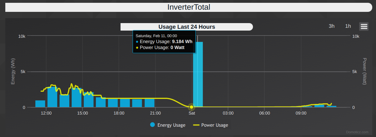

FWIW at EXACTLY 00:00 the plugin started receiving data again.
So I *think* the Growatt API does some kind of ratelimiting and resets this every day.
Screenshot 2023-02-11 11.33.41.png (193.75 KiB) Viewed 3004 times
Posts: 6677
Domoticz version: 2025.1
Re: Python Plugin: Growatt Inverter
See for example discussion here: https://github.com/indykoning/PyPi_Grow ... /issues/55
Seems 5 min polling is a good rate for keeping you unlocked.

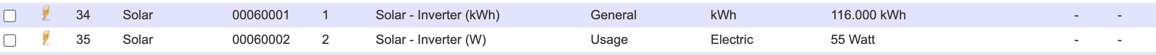

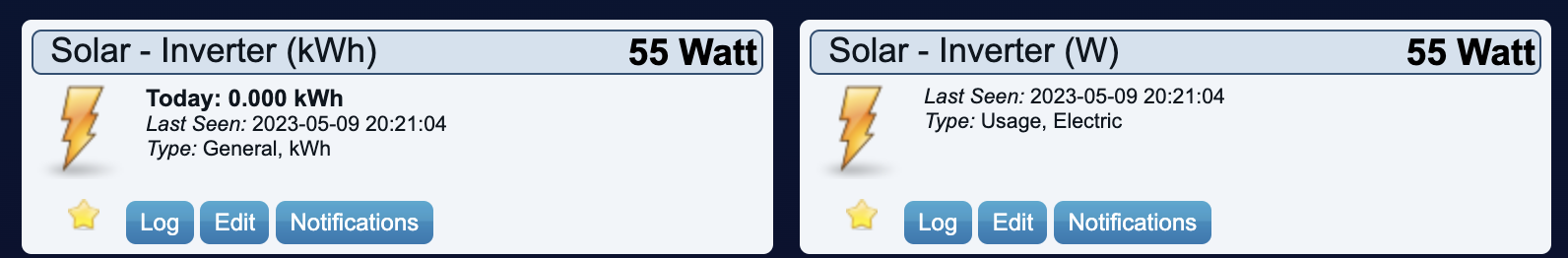

Hello everyone,
I hope I am not intruding as a new user. I found this plugin after configuring my new PV into Domoticz and I can't get the right output I think.
As you can see on the devices page the correct total generation is given (116kWh) but on the dashboard I get a duplication of the current wattage.
Am I doing something wrong? I tried reinstalling the plugin but to no avail.
I was hoping one of you experts could shed light on this?
Screenshot 2023-05-09 at 20.26.16.png (80.55 KiB) Viewed 2597 times
Screenshot 2023-05-09 at 20.26.33.png (43.07 KiB) Viewed 2597 times
Posts: 6677
This is normal behavior, just let it run a couple of days and you will see how it works.

janvdberg wrote: Monday 13 February 2023 7:51
waltervl wrote: Saturday 11 February 2023 23:19 It cannot be changed, it is currently hardcoded in the plugin (6 heartbeats). The plugin author could add a setting parameter to be able to set polling to x minutes.
I think I figured it out.
After a successful API call, the plugin does 12 heartbeats (10 seconds per beat = 2 minutes). After these hardcoded heartbeats the plugin uses the runAgain variable to determine after how many EXTRA beats it should do another API call. The default is 6 (6 x 10 = 1 minute). So effectively you get an API call every 3 minutes (2+1).
I changed the runAgain variable on line 83 and line 227 to 18 (=3 minutes): so now I get an API call every 5 minutes (2+3).
This can be observed in the logs:

That seems to do the trick. But I still had problems with locking accounts. So I changed the value to 24 today. Now wait and see if that will work better.
