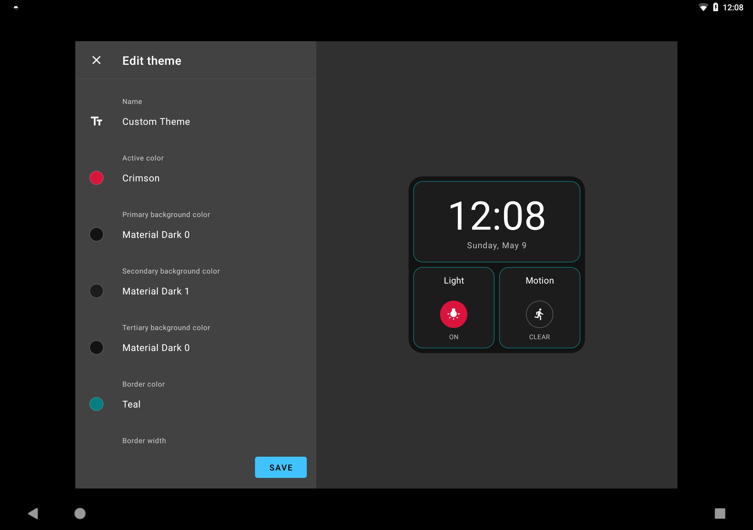

HomeHabit 8.0: Custom themes
Custom themes
The new custom themes feature is a great way to add personal touch to a dashboard. With custom themes it is possible to customize variety of widget style properties including changing colors, adding borders or rounded corners.
Starter version can have up to 2 custom themes, in addition to the standard themes.
Premium users can create unlimited number of themes.

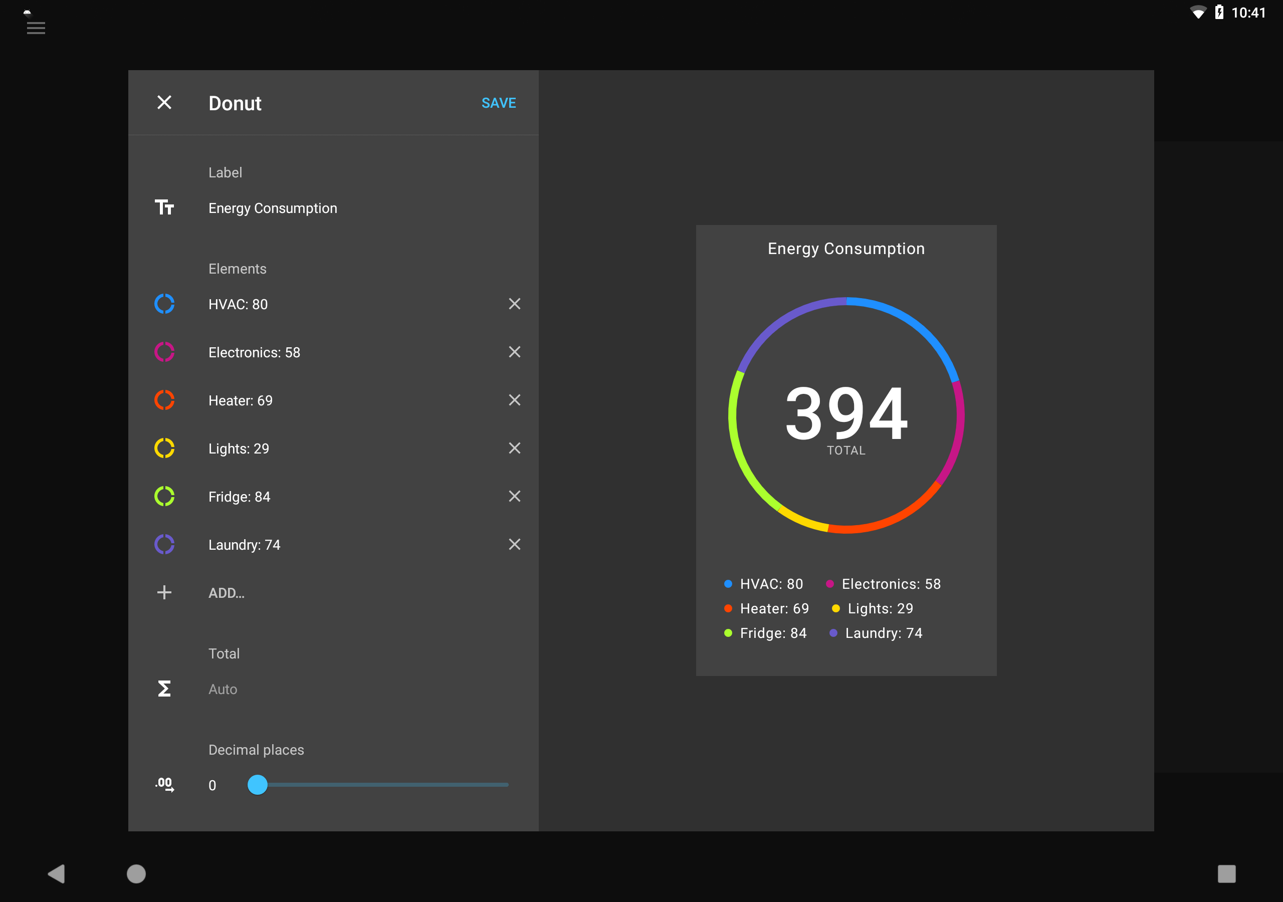

HomeHabit 10.0: Donut chart widget
Donut chart
The new donut chart widget that allows to quickly show data distribution in a single widget. It is great for displaying home energy consumption and other relative data.
The widget is available in various sizes and layouts to make the best use of dashboard space.
