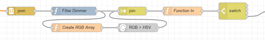

This post will show the flow and a short description.
The input to the json node comes from the MQTT input node, which has subscribed to domoticz/out.
No changes are required for this node.
The node, called "Filter Dimmer" filters all topics, which are not a Dimmer. You might want to change that, but as long as you use the same hardware it is not required.
In order to convert RGB values to HSV values, I created a function node that arranges the RGB values, so that the RGB>HSV node can convert it.
For both nodes, no changes are required.
The output of the RGB>HSV convert node is joined with the original flow.
No changes for the join node are required.
The next node is a Function node, that prepares the data, so that the nora node can handle it.
No changes are required.
The next node before the nora node is the switch node.
You have to configure, as many outputs, as you have MiLight lamps and give them your IDX numbers, so that they are routed to the correct nora node.
Regarding the nora node, you should configure it to your need with the right topic (IDX number) and tick all the boxes, except "If msg arrives on input, pass through to output:"
If everything is correctly configured, it is possible to control the nora node from Domoticz.
You will see that in the text below the node.

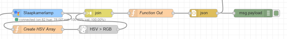

Next step is the right side of the nora node. The output to Domoticz.
From the nora node we have to change the HSV values back to RGB values.
So in order to convert HSV values to RGB values, I created a function node that arranges the HSV values, so that the HSV>RGB node can convert it.
For both nodes, no changes are required. Be aware that the box after "Scale Sat/Bri/Val" is ticked.
The output of the HSV>RGB convert node is joined with the original flow.
The next node is a Function node, that prepares the data, so that Domoticz can handle it.
Finally we go to a the json node and the output connects to the MQTT output node, which has subscribed to domoticz/in.
Feel free to implement it and to test it with real MiLight.

FireWizard wrote:This post will show the flow and a short description.
Best regards
Tested and working, thanks
The only problem is that my lights are rgbw, and I loose the white part...

Thanks so much! It works like a charm to change color and set my milights on and off! Only brightness controlls misses, but that not a great thing. Thank you thank you thank you!!!!!
FireWizard wrote: Wednesday 12 February 2020 17:52 Please find attached the flow:
[{"id":"8b9fe124.3e6fb8","type":"nora-light","z":"f01779c8.cd1ec","devicename":"Slaapkamerlamp","lightcolor":true,"brightnesscontrol":true,"turnonwhenbrightnesschanges":true,"passthru":false,"statepayload":true,"brightnessoverride":"","roomhint":"Slaapkamer","name":"Slaapkamerlamp","nora":"6f52ea33.833a2c","topic":"332","onvalue":"true","onvalueType":"bool","offvalue":"false","offvalueType":"bool","x":1150,"y":780,"wires":[["73400cd3.d7c65c","9961fafb.4f1698"]]},{"id":"170e5319.3f606d","type":"json","z":"f01779c8.cd1ec","name":"","property":"payload","action":"","pretty":false,"x":150,"y":780,"wires":[["2528055.8fdd3fa"]]},{"id":"bd209b8.55e9b68","type":"function","z":"f01779c8.cd1ec","name":"Function In ","func":"msg.topic = msg.payload[0].idx;\nif (msg.payload[0].nvalue !== 0)\n{\n    msg.payload = {\n        on : true,\n        brightness : msg.payload[0].Level,\n        color : {\n            spectrumHsv : {\n                hue : msg.payload[1].red,\n                saturation : msg.payload[1].green/100,\n                value : msg.payload[1].blue/100\n            }\n        }\n    }\n}\nelse if (msg.payload[0].nvalue === 0)\n{\n    msg.payload = {\n        on : false,\n        brightness : msg.payload[0].Level,\n        color : {\n            spectrumHsv : {\n                hue : msg.payload[1].red,\n                saturation : msg.payload[1].green/100,\n                value : msg.payload[1].blue/100\n            }\n        }\n    }\n}\nreturn msg;","outputs":1,"noerr":0,"x":730,"y":780,"wires":[["3fd178cf.d784"]]},{"id":"3fd178cf.d784","type":"switch","z":"f01779c8.cd1ec","name":"","property":"topic","propertyType":"msg","rules":[{"t":"eq","v":"1170","vt":"str"},{"t":"eq","v":"1171","vt":"str"},{"t":"eq","v":"1172","vt":"str"},{"t":"eq","v":"332","vt":"str"}],"checkall":"true","repair":false,"outputs":4,"x":910,"y":780,"wires":[[],[],[],["8b9fe124.3e6fb8"]]},{"id":"c678f72c.24a2c8","type":"function","z":"f01779c8.cd1ec","name":"Function Out","func":"var idx = parseInt(msg.topic);\nif ( msg.payload[0].on === true )\n{\n    msg.payload = {\n        \"command\" : \"setcolbrightnessvalue\",\n        \"idx\" : idx,\n        \"color\" : {\"m\":3,\"t\":0,\"r\":msg.payload[1].red,\"g\":msg.payload[1].green,\"b\":msg.payload[1].blue,\"cw\":0,\"ww\":0},\n        \"brightness\": msg.payload[0].brightness\n    };\n}\nelse if ( msg.payload[0].on === false )\n{\n    msg.payload = {\n        \"command\": \"switchlight\",\n        \"idx\": idx,\n        \"switchcmd\": \"Off\"\n        \n    };\n}\nreturn msg","outputs":1,"noerr":0,"x":1560,"y":780,"wires":[["20adf7d9.b1ec7"]]},{"id":"20adf7d9.b1ec7","type":"json","z":"f01779c8.cd1ec","name":"","property":"payload","action":"","pretty":false,"x":1750,"y":780,"wires":[["c14522c5.76fc68"]]},{"id":"c14522c5.76fc68","type":"debug","z":"f01779c8.cd1ec","name":"","active":true,"tosidebar":true,"console":false,"tostatus":false,"complete":"false","x":1930,"y":780,"wires":[]},{"id":"a9526656.b39dc8","type":"color-convert","z":"f01779c8.cd1ec","input":"rgb","output":"hsv","outputType":"object","scaleInput":false,"x":570,"y":840,"wires":[["6d505be6.981bac"]]},{"id":"2528055.8fdd3fa","type":"filter","z":"f01779c8.cd1ec","name":"Filter Dimmer","property":"payload.switchType","propertyType":"msg","asArray":false,"itemProperty":"","itemPropertyType":"item","rules":[{"t":"eq","v":"Dimmer","vt":"str","output":1}],"checkall":"true","outputs":1,"x":340,"y":780,"wires":[["963f3ce8.6fbc1","6d505be6.981bac"]]},{"id":"963f3ce8.6fbc1","type":"function","z":"f01779c8.cd1ec","name":"Create RGB Array","func":"msg.payload = {\n    red : msg.payload.Color.r,\n    green : msg.payload.Color.g,\n    blue : msg.payload.Color.b\n};\nreturn msg;","outputs":1,"noerr":0,"x":350,"y":840,"wires":[["a9526656.b39dc8"]]},{"id":"6d505be6.981bac","type":"join","z":"f01779c8.cd1ec","name":"","mode":"custom","build":"array","property":"payload","propertyType":"msg","key":"topic","joiner":"\\n","joinerType":"str","accumulate":false,"timeout":"","count":"2","reduceRight":false,"reduceExp":"","reduceInit":"","reduceInitType":"","reduceFixup":"","x":550,"y":780,"wires":[["bd209b8.55e9b68"]]},{"id":"49751c0a.4c20b4","type":"color-convert","z":"f01779c8.cd1ec","input":"hsv","output":"rgb","outputType":"object","scaleInput":true,"x":1370,"y":840,"wires":[["9961fafb.4f1698"]]},{"id":"73400cd3.d7c65c","type":"function","z":"f01779c8.cd1ec","name":"Create HSV Array","func":"msg.payload = {\n    hue : msg.payload.color.spectrumHsv.hue,\n    saturation : msg.payload.color.spectrumHsv.saturation,\n    value : msg.payload.color.spectrumHsv.value,\n};\nreturn msg;","outputs":1,"noerr":0,"x":1150,"y":840,"wires":[["49751c0a.4c20b4"]]},{"id":"9961fafb.4f1698","type":"join","z":"f01779c8.cd1ec","name":"","mode":"custom","build":"array","property":"payload","propertyType":"msg","key":"topic","joiner":"\\n","joinerType":"str","accumulate":false,"timeout":"","count":"2","reduceRight":false,"reduceExp":"","reduceInit":"","reduceInitType":"","reduceFixup":"","x":1370,"y":780,"wires":[["c678f72c.24a2c8"]]},{"id":"6f52ea33.833a2c","type":"nora-config","z":"","name":"Nora Config","group":"","notify":true}]
Re: Domoticz Google Assistant integration with node-red Easy Free Controlicz alternative!
Posted: Saturday 15 February 2020 13:58
by FireWizard
@EvJd
You wrote:
It works like a charm to change color and set my milights on and off! Only brightness controls misses
I do not understand this. Do you really mean brightness and not saturation?
As you know I do not have a real MiLight and the dimmer, I did setup was a virtual dimmer.
However, if I play with the buttons, slider and the color circle, I noticed on the texts below the NORA node, that they change accordingly.
The same happens, if I play with the slider and the colors in the Google Home App.
Also a Voice command, like (in Dutch) "OK, Google, Slaaplamer lamp, Helderheid 60%" functions correctly. The only thing, that I don"t see change is the value.
The only thing, I was not able to do, was to set the saturation by a Voice command. Probably this is just a matter of the right wordings.
Everything is fully synchronized between my virtual dimmer in Domoticz, Google Home, app, Voice commands and the text under the NORA node.
Is this the difference between a virtual dimmer and a real MiLight?
