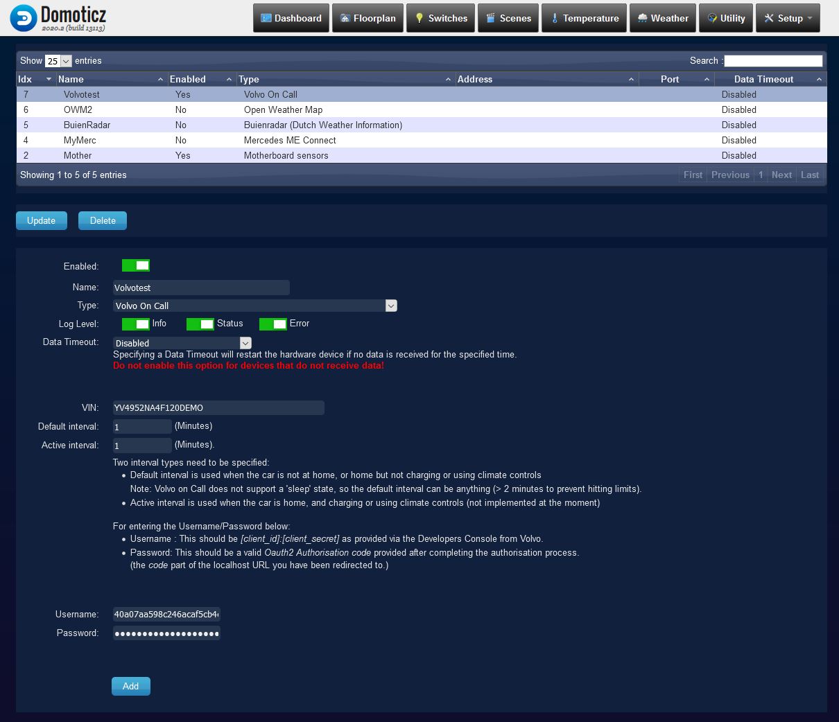

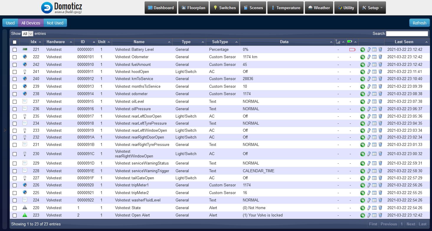

Found some time to play around with the Volvo Demo API and got some initial things working...
(see my github repo https://github.com/kiddigital/domoticz/ ... olvooncall)
Devices:
Setup:
Work in progress and Authorization does not (really) work as the 'password' now is the 'access_token' from the portal ;)
Opening a new thread later is fine by me :)
I see it and the screenshots looks already good. :)
Some issues perhaps to be aware of.
1. Currently the Volvo DEMO car returns 35 sensors and does not have any possibilities to send controls.
My private car (Volvo V40 from 2019) returns 36 sensors, while the documentation describes 39 sensors
I implemented them all, but some of them are more useful then others.
2. In the second screenshot it looks that you have a configuration field for the VIN
This is quite a long number and may lead to mistakes, if you fill it in manually.
It is not necessary, as you can ask (at least if the provided credentials are correct) for it:
https://api.volvocars.com/extended-vehicle/v1/vehicles. It will return the VIN.

For the implementation I am re-using the eVehicle framework that is also used for both the Tesla and the Mercedes implementation.
The framework now has a set of given sensors it support at the moment (based on the first implementation of the Tesla) but could/should be extended to support other sensors as well.
For now I mapped the Volvo sensors on the existing set.
Additionally, all available sensors that are provided by the API for the given car are also processed and added as 'custom sensors' with some guess work about the type (switch for example when the value looks like a boolean, or text as generic fall back). This does mean that some values could be there twice :) Once as a value mapped to one of the existing sensors in the framework and once as a custom sensor.
Playing with the idea of adding a toggle on the settings screen to (dis)allow the creation of custom (read 'unmapped') sensors, so users can decide if they want everything, but maybe the types could be wrong or not suited, or only the ones that are mapped perfectly.
FireWizard wrote:2. In the second screenshot it looks that you have a configuration field for the VIN
I noticed this indeed but decided to stick with entering the VIN for a few reasons:
  • That is how the eVehicle framework works
  • In theory the Volvo API can returned multiple VIN's, which one to pick then?
  • You only have to enter the VIN once at setup, and errorlogging shows quick enough if you entered a (wrong) VIN that does not match the VIN(s) you have access to.
  • And entering your own VIN is a good way to double check that it is your car :)

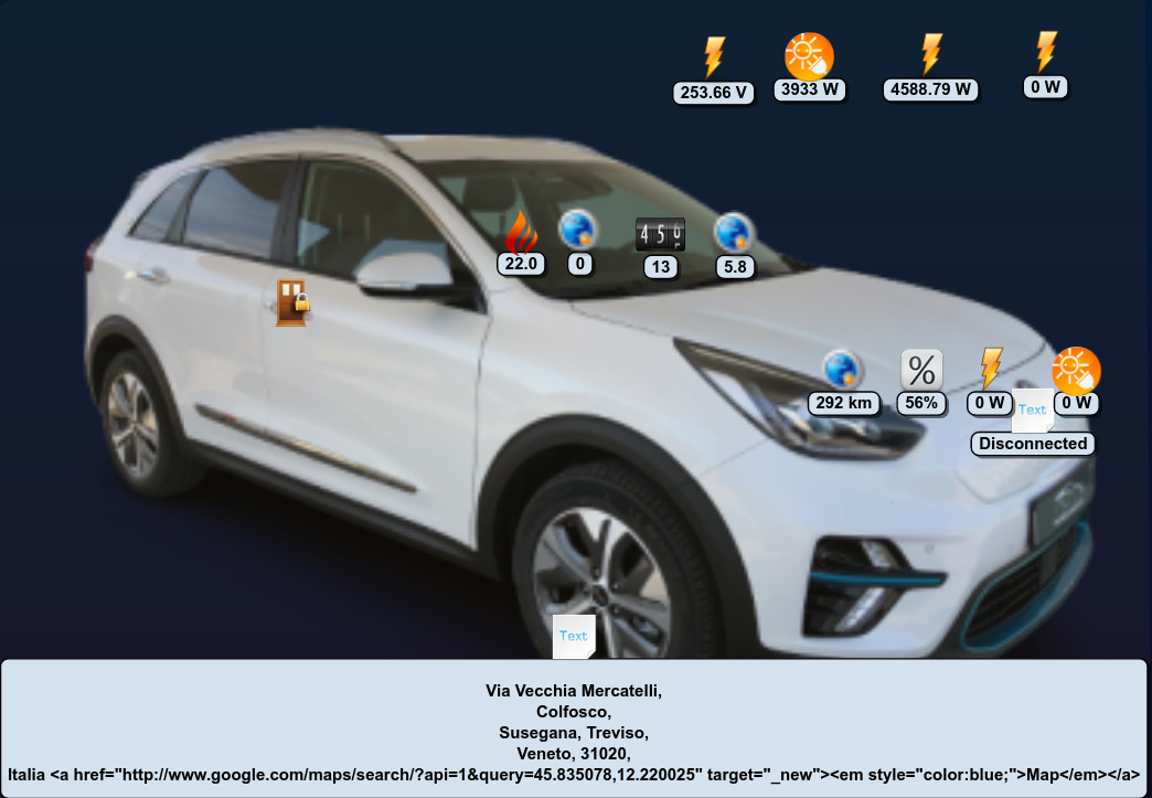

I've written a plugin for Domoticz to show and manage Kia and Hyundai vehicles, based on the hyundai-kia-connect-api module.
More info at https://github.com/CreasolTech/domoticz-hyundai-kia
Paolo
