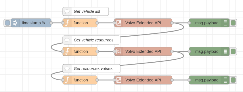

I have been playing around with the new Volvo Extended Vehicle API together with Node Red.
In order, to be able to compare the results against the currently used Python script from Molobrakos, together with MQTT and Node Red, I did not use the DEMO car, but I used my own car (with the Volvo on Call credentials).
I have to say, it is really one of the easiest API's I ever implemented. Very straight forward. The only confusing and disturbing factor is the way, they do the authentication. The generated key values time out and you have to insert a new value after some time of inactivity.
(E.g. if you go for dinner or another break and you return afterwards, your flow has stopped and requires a new key).
It works in 3 steps.
1. Request your Vehicle Identification Number (VIN). You can find this number also in your app, license papers or windscreen.
2. Request the resources for this car with the VIN number.
3. Request for every available resource the value.
The result is shown below.
The flow starts with a simple "Inject" node, which triggers a "Function" node.
The contents is:
msg.url = 'https://api.volvocars.com/extended-vehicle/v1/vehicles';
return msg;
This is the first URL to query and it will return the vehicle ID (VIN)
I created a subflow, containing a "Function" node, with the msg.headers and the "HTTP request" node.
This subflow can be used on multiple places (in my case 3) and saves me the hassle of inserting keys in multiple places.
The result you can see in the first returned message in the picture below.
If you have more Volvo cars registered, you will get returned more than 1 ID in an array. However I own only 1 Volvo, so there is only 1 element in the array.
The output is connected to the input of another "Function" node and the vehicle ID is inserted in the next URL to call.
for (var i = 0; i < msg.payload.vehicles.length; i++) {
var newMsg = {};
newMsg.url = 'https://api.volvocars.com/extended-vehicle/v1/vehicles/' + msg.payload.vehicles[i].id + '/resources';
node.send(newMsg);
return null;

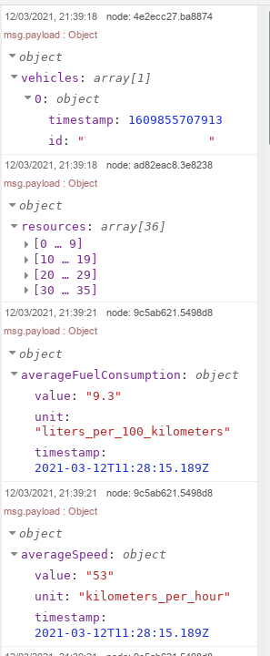

This will result in an array of all available resources for this type of car. See the second message in the picture below.
The main contents of each element is the URL to query for the available data.
The output is connected to the input of another "Function" node and the URL found in the previous result is used to get the data for the available resources. In my case it are 36 resources.
The contents of the "Function" node is as follows:
for (var i = 0; i < msg.payload.resources.length; i++) {
var newMsg = {};
newMsg.url = msg.payload.resources[i].href;
node.send(newMsg);
return null;
Next step is to convert to the required Domoticz format for each resource and push the data to a MQTT Output node and to Domoticz.
That is quite simple to do.
See the picture below for the messages (The VIN has been obscured):
This gives you a small overview of what to expect from the API.

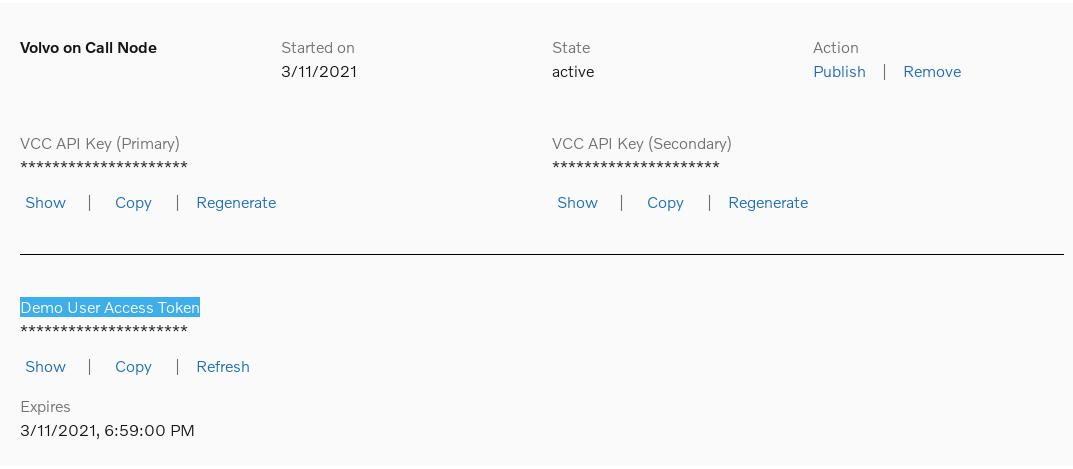

@FireWizard , just played a little again with the Volvo API but somehow the console does not generate a usable new access token. It generates as new one, but the expire time of the new token remains at the initial time in the past (in my case 2 days ago). So with this new, but expired, accesstoken I cannot access the API :(
Makes it hard (almost impossible) to continue at this moment. Hopefully this problem gets resolved soon.
FireWizard
Posts: 1980
Location: Voorthuizen (NL)
Re: Connected Cars
Post by FireWizard »
@kiddigital
I'm also playing, but I have difficulties to get the DEMO "car" running. I'm able to get an authorization with my own car (as you could see).
The hassle, I meet is that the authorization times out after a hour. Then I have to generate a new token and then I have another hour.
I will try to get the DEMO running and I will let you know what I meet.

Hi @kiddigital,
I tried it as well, but same result.
I have sent an email to the Swedes. Let's wait on their reaction.
Dear Sir/Lady,
Since 3/11/2021, 7:59:01 PM the Volvo Extended Vehicle API has stopped
updating its Demo User Access Token.
So it is no longer possible to test applications with the DEMO "car".
With the own car it works correct, but a timeout of 1 hour is rather limited.

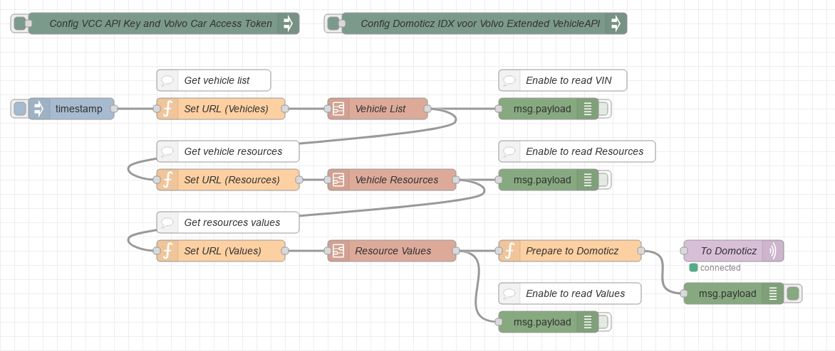

HI all,
I have finished the Node Red flow for the new Volvo Extended Vehicle API and I'm waiting for the Volvo approval.
According to their website, this has to be done currently manually and will take between 10 and 14 days. Working days?
The complete flow can handle all 39 sensors available. However it has been tested with 36 sensors of my private car and the 35 sensors of the "Demo car", offered by Volvo.
The complete flow looks as follows:
The complete flow, you will find below:
[{"id":"74aed579.228d04","type":"subflow","name":"Volvo Extended API","info":"Subflow to provide Headers to HTTP request.\nRequires msg.url as input.","category":"","in":[{"x":120,"y":80,"wires":[{"id":"969e3345.457bf8"}]}],"out":[{"x":600,"y":80,"wires":[{"id":"11de1bbe.5ff6d4","port":0}]}],"env":[],"color":"#DDAA99"},{"id":"11de1bbe.5ff6d4","type":"http request","z":"74aed579.228d04","name":"","method":"GET","ret":"obj","paytoqs":"ignore","url":"","tls":"","persist":false,"proxy":"","authType":"","x":450,"y":80,"wires":[[]]},{"id":"969e3345.457bf8","type":"function","z":"74aed579.228d04","name":"","func":"msg.headers = {};\nmsg.headers['accept'] = 'application/json';\nmsg.headers['vcc-api-key'] = global.get(\"vcc-api-key\");\nmsg.headers['authorization'] = global.get(\"authorization\");\nreturn msg;","outputs":1,"noerr":0,"initialize":"","finalize":"","x":260,"y":80,"wires":[["11de1bbe.5ff6d4"]]},{"id":"fc2c4745.3d9bb8","type":"tab","label":"Volvo","disabled":false,"info":""},{"id":"61a810cc.ef33d","type":"inject","z":"fc2c4745.3d9bb8","name":"","props":[{"p":"payload"},{"p":"topic","vt":"str"}],"repeat":"","crontab":"","once":false,"onceDelay":0.1,"topic":"","payload":"","payloadType":"date","x":140,"y":160,"wires":[["f9d10275.84991"]]},{"id":"4e2ecc27.ba8874","type":"debug","z":"fc2c4745.3d9bb8","name":"","active":false,"tosidebar":true,"console":false,"tostatus":false,"complete":"false","statusVal":"","statusType":"auto","x":810,"y":160,"wires":[]},{"id":"f9d10275.84991","type":"function","z":"fc2c4745.3d9bb8","name":"Set URL (Vehicles)","func":"msg.url = 'https://api.volvocars.com/extended-vehicle/v1/vehicles';\nreturn msg;","outputs":1,"noerr":0,"initialize":"","finalize":"","x":350,"y":160,"wires":[["2480aadf.fe5f76"]]},{"id":"95d66788.ef6778","type":"comment","z":"fc2c4745.3d9bb8","name":"Get vehicle list","info":"","x":340,"y":120,"wires":[]},{"id":"7c468a1d.85bcb4","type":"comment","z":"fc2c4745.3d9bb8","name":"Get vehicle resources","info":"","x":360,"y":220,"wires":[]},{"id":"ad82eac8.3e8238","type":"debug","z":"fc2c4745.3d9bb8","name":"","active":false,"tosidebar":true,"console":false,"tostatus":false,"complete":"payload","targetType":"msg","statusVal":"","statusType":"auto","x":810,"y":260,"wires":[]},{"id":"2fd99f41.6339c8","type":"function","z":"fc2c4745.3d9bb8","name":"Set URL (Resources)","func":"for (var i = 0; i < msg.payload.vehicles.length; i++) {\nvar newMsg = {};\nnewMsg.url = 'https://api.volvocars.com/extended-vehicle/v1/vehicles/' + msg.payload.vehicles[i].id + '/resources';\nnode.send(newMsg);\nnode.done();\n}\nreturn null;","outputs":1,"noerr":0,"initialize":"","finalize":"","x":360,"y":260,"wires":[["bd630a81.6df9d"]]},{"id":"bd630a81.6df9d","type":"subflow:74aed579.228d04","z":"fc2c4745.3d9bb8","name":"Vehicle Resources","env":[],"x":590,"y":260,"wires":[["ad82eac8.3e8238","bc7718ad.62a178"]]},{"id":"bc7718ad.62a178","type":"function","z":"fc2c4745.3d9bb8","name":"Set URL (Values)","func":"for (var i = 0; i < msg.payload.resources.length; i++) {\nvar newMsg = {};\nnewMsg.topic = msg.payload.resources[i].name;\nnewMsg.url = msg.payload.resources[i].href;\nnode.send(newMsg);\nnode.done();\n}\nreturn null;","outputs":1,"noerr":0,"initialize":"","finalize":"","x":350,"y":360,"wires":[["19b196f5.08c2d1"]]},{"id":"9c5ab621.5498d8","type":"debug","z":"fc2c4745.3d9bb8","name":"","active":false,"tosidebar":true,"console":false,"tostatus":false,"complete":"payload","targetType":"msg","statusVal":"","statusType":"auto","x":810,"y":460,"wires":[]},{"id":"19b196f5.08c2d1","type":"subflow:74aed579.228d04","z":"fc2c4745.3d9bb8","name":"Resource Values","env":[],"x":590,"y":360,"wires":[["9c5ab621.5498d8","10b207ce.d086e8"]]},{"id":"2480aadf.fe5f76","type":"subflow:74aed579.228d04","z":"fc2c4745.3d9bb8","name":"Vehicle List","env":[],"x":570,"y":160,"wires":[["4e2ecc27.ba8874","2fd99f41.6339c8"]]},{"id":"abe0e8f9.d4fd2","type":"comment","z":"fc2c4745.3d9bb8","name":"Get resources values","info":"","x":360,"y":320,"wires":[]},{"id":"e1458998.134a1","type":"config","z":"fc2c4745.3d9bb8","name":"Config Domoticz IDX voor Volvo Extended VehicleAPI","properties":[{"p":"IDXaverageFuelConsumption","pt":"flow","to":"1","tot":"num"},{"p":"IDXaverageSpeed","pt":"flow","to":"2","tot":"num"},{"p":"IDXbackupBatteryRemaining","pt":"flow","to":"3","tot":"num"},{"p":"IDXbrakeFluid","pt":"flow","to":"4","tot":"num"},{"p":"IDXcarLocked","pt":"flow","to":"5","tot":"num"},{"p":"IDXdistanceToEmpty","pt":"flow","to":"6","tot":"num"},{"p":"IDXengineCoolantLevel","pt":"flow","to":"7","tot":"num"},{"p":"IDXengineCoolantTemp","pt":"flow","to":"8","tot":"num"},{"p":"IDXengineHoursToService","pt":"flow","to":"9","tot":"num"},{"p":"IDXengineRunning","pt":"flow","to":"10","tot":"num"},{"p":"IDXexternalTemp","pt":"flow","to":"11","tot":"num"},{"p":"IDXfrontLeftDoorOpen","pt":"flow","to":"12","tot":"num"},{"p":"IDXfrontLeftTyrePressure","pt":"flow","to":"13","tot":"num"},{"p":"IDXfrontLeftWindowOpen","pt":"flow","to":"14","tot":"num"},{"p":"IDXfrontRightDoorOpen","pt":"flow","to":"15","tot":"num"},{"p":"IDXfrontRightTyrePressure","pt":"flow","to":"16","tot":"num"},{"p":"IDXfrontRightWindowOpen","pt":"flow","to":"17","tot":"num"},{"p":"IDXfuelAmount","pt":"flow","to":"18","tot":"num"},{"p":"IDXhoodOpen","pt":"flow","to":"19","tot":"num"},{"p":"IDXkmToService","pt":"flow","to":"20","tot":"num"},{"p":"IDXmainBatteryStatus","pt":"flow","to":"21","tot":"num"},{"p":"IDXmonthsToService","pt":"flow","to":"22","tot":"num"},{"p":"IDXodometer","pt":"flow","to":"23","tot":"num"},{"p":"IDXoilLevel","pt":"flow","to":"24","tot":"num"},{"p":"IDXrearLeftDoorOpen","pt":"flow","to":"25","tot":"num"},{"p":"IDXrearLeftTyrePressure","pt":"flow","to":"26","tot":"num"},{"p":"IDXrearLeftWindowOpen","pt":"flow","to":"27","tot":"num"},{"p":"IDXrearRightDoorOpen","pt":"flow","to":"28","tot":"num"},{"p":"IDXrearRightTyrePressure","pt":"flow","to":"29","tot":"num"},{"p":"IDXrearRightWindowOpen","pt":"flow","to":"30","tot":"num"},{"p":"IDXserviceWarningStatus","pt":"flow","to":"31","tot":"num"},{"p":"IDXserviceWarningTrigger","pt":"flow","to":"32","tot":"num"},{"p":"IDXtailGateOpen","pt":"flow","to":"33","tot":"num"},{"p":"IDXtripMeter1","pt":"flow","to":"34","tot":"num"},{"p":"IDXtripMeter2","pt":"flow","to":"35","tot":"num"},{"p":"IDXwasherFluidLevel","pt":"flow","to":"36","tot":"num"},{"p":"IDXoilPressure","pt":"flow","to":"37","tot":"num"},{"p":"IDXbulbFailure","pt":"flow","to":"38","tot":"num"},{"p":"IDXcabOpen","pt":"flow","to":"39","tot":"num"}],"active":true,"x":720,"y":40,"wires":[]},{"id":"10b207ce.d086e8","type":"function","z":"fc2c4745.3d9bb8","name":"Prepare to Domoticz","func":"switch (msg.topic) {\n\n    case \"averageSpeed\":\n    msg.payload = {\"command\":\"udevice\",\"idx\":flow.get(\"IDX\" + msg.topic),\"nvalue\":0,\"svalue\":msg.payload.averageSpeed.value};\n    break;\n\n    case \"averageFuelConsumption\":\n    msg.payload = {\"command\":\"udevice\",\"idx\":flow.get(\"IDX\" + msg.topic),\"nvalue\":0,\"svalue\":msg.payload.averageFuelConsumption.value};\n    break;\n\n    case \"brakeFluid\":\n    msg.payload = {\"command\":\"udevice\",\"idx\":flow.get(\"IDX\" + msg.topic),\"nvalue\":0,\"svalue\":msg.payload.brakeFluid.value};\n    break;\n\n    case \"backupBatteryRemaining\":\n    msg.payload = {\"command\":\"udevice\",\"idx\":flow.get(\"IDX\" + msg.topic),\"nvalue\":0,\"svalue\":msg.payload.backupBatteryRemaining.value};\n    break;\n\n    case \"carLocked\":\n    msg.payload = {\"command\":\"udevice\",\"idx\":flow.get(\"IDX\" + msg.topic),\"nvalue\":0,\"svalue\":msg.payload.carLocked.value};\n    break;\n\n    case \"distanceToEmpty\":\n    msg.payload = {\"command\":\"udevice\",\"idx\":flow.get(\"IDX\" + msg.topic),\"nvalue\":0,\"svalue\":msg.payload.distanceToEmpty.value};\n    break;\n\n    case \"engineCoolantLevel\":\n    msg.payload = {\"command\":\"udevice\",\"idx\":flow.get(\"IDX\" + msg.topic),\"nvalue\":0,\"svalue\":msg.payload.engineCoolantLevel.value};\n    break;\n\n    case \"engineHoursToService\":\n    msg.payload = {\"command\":\"udevice\",\"idx\":flow.get(\"IDX\" + msg.topic),\"nvalue\":0,\"svalue\":msg.payload.engineHoursToService.value};\n    break;\n\n    case \"engineCoolantTemp\":\n    msg.payload = {\"command\":\"udevice\",\"idx\":flow.get(\"IDX\" + msg.topic),\"nvalue\":0,\"svalue\":msg.payload.engineCoolantTemp.value};\n    break;\n\n    case \"engineRunning\":\n    msg.payload = {\"command\":\"udevice\",\"idx\":flow.get(\"IDX\" + msg.topic),\"nvalue\":0,\"svalue\":msg.payload.engineRunning.value};\n    break;\n\n    case \"externalTemp\":\n    msg.payload = {\"command\":\"udevice\",\"idx\":flow.get(\"IDX\" + msg.topic),\"nvalue\":0,\"svalue\":msg.payload.externalTemp.value};\n    break;\n\n    case \"frontLeftDoorOpen\":\n    msg.payload = {\"command\":\"udevice\",\"idx\":flow.get(\"IDX\" + msg.topic),\"nvalue\":0,\"svalue\":msg.payload.frontLeftDoorOpen.value};\n    break;\n\n    case \"frontLeftTyrePressure\":\n    msg.payload = {\"command\":\"udevice\",\"idx\":flow.get(\"IDX\" + msg.topic),\"nvalue\":0,\"svalue\":msg.payload.frontLeftTyrePressure.value};\n    break;\n\n    case \"frontLeftWindowOpen\":\n    msg.payload = {\"command\":\"udevice\",\"idx\":flow.get(\"IDX\" + msg.topic),\"nvalue\":0,\"svalue\":msg.payload.frontLeftWindowOpen.value};\n    break;\n\n    case \"frontRightDoorOpen\":\n    msg.payload = {\"command\":\"udevice\",\"idx\":flow.get(\"IDX\" + msg.topic),\"nvalue\":0,\"svalue\":msg.payload.frontRightDoorOpen.value};\n    break;\n\n    case \"frontRightTyrePressure\":\n    msg.payload = {\"command\":\"udevice\",\"idx\":flow.get(\"IDX\" + msg.topic),\"nvalue\":0,\"svalue\":msg.payload.frontRightTyrePressure.value};\n    break;\n\n    case \"frontRightWindowOpen\":\n    msg.payload = {\"command\":\"udevice\",\"idx\":flow.get(\"IDX\" + msg.topic),\"nvalue\":0,\"svalue\":msg.payload.frontRightWindowOpen.value};\n    break;\n\n    case \"fuelAmount\":\n    msg.payload = {\"command\":\"udevice\",\"idx\":flow.get(\"IDX\" + msg.topic),\"nvalue\":0,\"svalue\":msg.payload.fuelAmount.value};\n    break;\n\n    case \"hoodOpen\":\n    msg.payload = {\"command\":\"udevice\",\"idx\":flow.get(\"IDX\" + msg.topic),\"nvalue\":0,\"svalue\":msg.payload.hoodOpen.value};\n    break;\n\n    case \"kmToService\":\n    msg.payload = {\"command\":\"udevice\",\"idx\":flow.get(\"IDX\" + msg.topic),\"nvalue\":0,\"svalue\":msg.payload.kmToService.value};\n    break;\n\n    case \"mainBatteryStatus\":\n    msg.payload = {\"command\":\"udevice\",\"idx\":flow.get(\"IDX\" + msg.topic),\"nvalue\":0,\"svalue\":msg.payload.mainBatteryStatus.value};\n    break;\n\n    case \"monthsToService\":\n    msg.payload = {\"command\":\"udevice\",\"idx\":flow.get(\"IDX\" + msg.topic),\"nvalue\":0,\"svalue\":msg.payload.monthsToService.value};\n    break;\n\n    case \"odometer\":\n    msg.payload = {\"command\":\"udevice\",\"idx\":flow.get(\"IDX\" + msg.topic),\"nvalue\":0,\"svalue\":msg.payload.odometer.value};\n    break;\n\n    case \"oilLevel\":\n    msg.payload = {\"command\":\"udevice\",\"idx\":flow.get(\"IDX\" + msg.topic),\"nvalue\":0,\"svalue\":msg.payload.oilLevel.value};\n    break;\n\n    case \"oilPressure\":\n    msg.payload = {\"command\":\"udevice\",\"idx\":flow.get(\"IDX\" + msg.topic),\"nvalue\":0,\"svalue\":msg.payload.oilPressure.value};\n    break;\n\n    case \"rearLeftWindowOpen\":\n    msg.payload = {\"command\":\"udevice\",\"idx\":flow.get(\"IDX\" + msg.topic),\"nvalue\":0,\"svalue\":msg.payload.rearLeftWindowOpen.value};\n    break;\n\n    case \"rearRightDoorOpen\":\n    msg.payload = {\"command\":\"udevice\",\"idx\":flow.get(\"IDX\" + msg.topic),\"nvalue\":0,\"svalue\":msg.payload.rearRightDoorOpen.value};\n    break;\n\n    case \"rearRightTyrePressure\":\n    msg.payload = {\"command\":\"udevice\",\"idx\":flow.get(\"IDX\" + msg.topic),\"nvalue\":0,\"svalue\":msg.payload.rearRightTyrePressure.value};\n    break;\n\n    case \"rearLeftDoorOpen\":\n    msg.payload = {\"command\":\"udevice\",\"idx\":flow.get(\"IDX\" + msg.topic),\"nvalue\":0,\"svalue\":msg.payload.rearLeftDoorOpen.value};\n    break;\n\n    case \"rearLeftTyrePressure\":\n    msg.payload = {\"command\":\"udevice\",\"idx\":flow.get(\"IDX\" + msg.topic),\"nvalue\":0,\"svalue\":msg.payload.rearLeftTyrePressure.value};\n    break;\n\n    case \"washerFluidLevel\":\n    msg.payload = {\"command\":\"udevice\",\"idx\":flow.get(\"IDX\" + msg.topic),\"nvalue\":0,\"svalue\":msg.payload.washerFluidLevel.value};\n    break;\n\n    case \"serviceWarningTrigger\":\n    msg.payload = {\"command\":\"udevice\",\"idx\":flow.get(\"IDX\" + msg.topic),\"nvalue\":0,\"svalue\":msg.payload.serviceWarningTrigger.value};\n    break;\n\n    case \"tripMeter1\":\n    msg.payload = {\"command\":\"udevice\",\"idx\":flow.get(\"IDX\" + msg.topic),\"nvalue\":0,\"svalue\":msg.payload.tripMeter1.value};\n    break;\n\n    case \"tripMeter2\":\n    msg.payload = {\"command\":\"udevice\",\"idx\":flow.get(\"IDX\" + msg.topic),\"nvalue\":0,\"svalue\":msg.payload.tripMeter2.value};\n    break;\n\n    case \"serviceWarningStatus\":\n    msg.payload = {\"command\":\"udevice\",\"idx\":flow.get(\"IDX\" + msg.topic),\"nvalue\":0,\"svalue\":msg.payload.serviceWarningStatus.value};\n    break;\n\n    case \"tailGateOpen\":\n    msg.payload = {\"command\":\"udevice\",\"idx\":flow.get(\"IDX\" + msg.topic),\"nvalue\":0,\"svalue\":msg.payload.tailGateOpen.value};\n    break;\n\n    case \"rearRightWindowOpen\":\n    msg.payload = {\"command\":\"udevice\",\"idx\":flow.get(\"IDX\" + msg.topic),\"nvalue\":0,\"svalue\":msg.payload.rearRightWindowOpen.value};\n    break;\n\n    case \"bulbFailure\":\n    msg.payload = {\"command\":\"udevice\",\"idx\":flow.get(\"IDX\" + msg.topic),\"nvalue\":0,\"svalue\":msg.payload.bulbFailure.value};\n    break;\n\n    case \"cabOpen\":\n    msg.payload = {\"command\":\"udevice\",\"idx\":flow.get(\"IDX\" + msg.topic),\"nvalue\":0,\"svalue\":msg.payload.cabOpen.value};\n    break;\n\n}\nreturn msg;","outputs":1,"noerr":0,"initialize":"","finalize":"","x":840,"y":360,"wires":[["abf0ba6a.04619"]]},{"id":"abf0ba6a.04619","type":"debug","z":"fc2c4745.3d9bb8","name":"","active":true,"tosidebar":true,"console":false,"tostatus":false,"complete":"payload","targetType":"msg","statusVal":"","statusType":"auto","x":1070,"y":420,"wires":[]},{"id":"40715bb7.f232dc","type":"config","z":"fc2c4745.3d9bb8","name":"Config VCC API Key and Volvo Car Access Token","properties":[{"p":"vcc-api-key","pt":"global","to":"","tot":"str"},{"p":"authorization","pt":"global","to":"","tot":"str"}],"active":true,"x":270,"y":40,"wires":[]},{"id":"95d6631b.f1db7","type":"mqtt out","z":"fc2c4745.3d9bb8","name":"To Domoticz","topic":"domoticz/in","qos":"2","retain":"false","broker":"f9f13036.e28b58","x":1070,"y":360,"wires":[]},{"id":"8b47d185.2d8ad","type":"comment","z":"fc2c4745.3d9bb8","name":"Enable to read VIN","info":"","x":830,"y":120,"wires":[]},{"id":"13e36eda.378481","type":"comment","z":"fc2c4745.3d9bb8","name":"Enable to read Resources","info":"","x":850,"y":220,"wires":[]},{"id":"2601a3ab.cc1514","type":"comment","z":"fc2c4745.3d9bb8","name":"Enable to read Values","info":"","x":840,"y":420,"wires":[]},{"id":"f9f13036.e28b58","type":"mqtt-broker","name":"localhost","broker":"127.0.0.1","port":"1883","clientid":"","usetls":false,"compatmode":true,"keepalive":"60","cleansession":true,"birthTopic":"","birthQos":"0","birthRetain":"false","birthPayload":"","closeTopic":"","closeQos":"0","closePayload":"","willTopic":"","willQos":"0","willPayload":""}]
You will also need a subflow, which is called "Volvo Extended API",
You will find this flow below:
[{"id":"74aed579.228d04","type":"subflow","name":"Volvo Extended API","info":"Subflow to provide Headers to HTTP request.\nRequires msg.url as input.","category":"","in":[{"x":120,"y":80,"wires":[{"id":"969e3345.457bf8"}]}],"out":[{"x":600,"y":80,"wires":[{"id":"11de1bbe.5ff6d4","port":0}]}],"env":[],"color":"#DDAA99"},{"id":"11de1bbe.5ff6d4","type":"http request","z":"74aed579.228d04","name":"","method":"GET","ret":"obj","paytoqs":"ignore","url":"","tls":"","persist":false,"proxy":"","authType":"","x":450,"y":80,"wires":[[]]},{"id":"969e3345.457bf8","type":"function","z":"74aed579.228d04","name":"","func":"msg.headers = {};\nmsg.headers['accept'] = 'application/json';\nmsg.headers['vcc-api-key'] = global.get(\"vcc-api-key\");\nmsg.headers['authorization'] = global.get(\"authorization\");\nreturn msg;","outputs":1,"noerr":0,"initialize":"","finalize":"","x":260,"y":80,"wires":[["11de1bbe.5ff6d4"]]}]
This subflow consists of two nodes.

The flow itself has already been explained in my post, dated 12 Mar 2021, 22:22
New are two "Configuration" nodes, which you have to install from the Palette.
You can find this node under: node-red-contrib-config
More info at: https://flows.nodered.org/node/node-red-contrib-config
The left "Configuration" node is used for the configuration of the variables for vcc-api-key and authorization.
This is more convenient than to look for a "Function" node in a Subflow.
The right "Configuration" node is used to configure the Domoticz IDX numbers.
All 39 possible sensors are pre-configured. If someone want to reduce the number of received sensors, that will be sent to Domoticz, you can simple delete the environment variable. Delete also the corresponding block of code in the last "Function" node.
The Confiuration node sets an environment variable composed by IDX and the topic (so example: IDXaverageFuelConsumption)
The topic is set in the last Function node that parses the array, received from Volvo.

Every Volvo user can test this flow by creating an account at: https://developer.volvocars.com/volvo-api/ (Sign up or Log in)
Next step: CREATE APPLICATION and give your application a name.
Let me know in case of problems.
