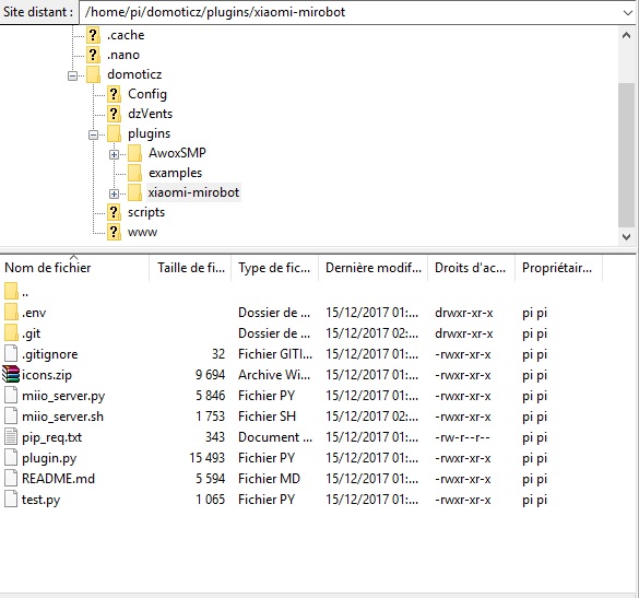

Like this?
Thanks for your help.
- Sans titre.jpg (82.37 KiB) Viewed 7854 times
- domoticzplugin.jpg (88.64 KiB) Viewed 7854 times

Re: Python plugin: Xiaomi Mi Robot Vacuum
@Noka
Folder structure looks good.
Which version domoticz? Plugin for 8.153+. Also, maybe you has compiled domoticz without python support? I mean python was not installed when you compiled domoticz? Also need to restart domoticz after plugin installation.
