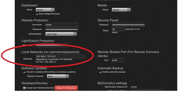

I am having an issue with configuring authentication.
As per instruction, in config.json I updated:
"server": "127.0.0.1"
To:
"server": "<user>:<pass>@127.0.0.1"
Where <user> and <pass> are the login credentials that I have set for logging into the Domoticz web interface.
Without authentication all is working well.
With authentication enabled I have an endless loop of retry attempts in the forever logs.

I am not sure whether to set authentication method to "Login Page" or "Basic-Auth" in the Domoticz settings.
Both are unsuccessful.

nfaber wrote:I am having an issue with configuring authentication.
To:
I really would like to have the authentication, as I added my alarm system in Domoticz now as well.
It would be great to be able to operate it using the new iOS10 Home app.
I think I got around this by setting Domoticz to allow login without username or password from devices on the local network in settings.
Last edited by markk on Wednesday 28 September 2016 17:25, edited 1 time in total.
Yeah, there's an issue with authentication in the current npm / git master branch. You could update to the mqtt-integration branch to have a sneak peak of this issue fixed, or wait a bit until it comes available on npm.
You could also do what @markk says, just tick the 'local' box and use 127.0.0.1 as server url.
