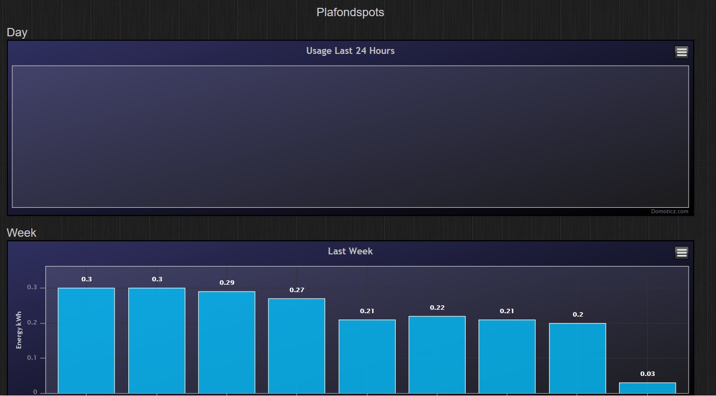

on every device(usage, Kwh, temperature, lux) i still have the 24 hour graphic available EXEPT for the kWh meters.
everything is there exept for the 24 hour graphic.
i checked the usage device and that one is also showing the graphic as well as the lights being switched on
is this normal or did they remove the usage graphic from the kWh device?
if not will it come back later on or do i need to reset again.

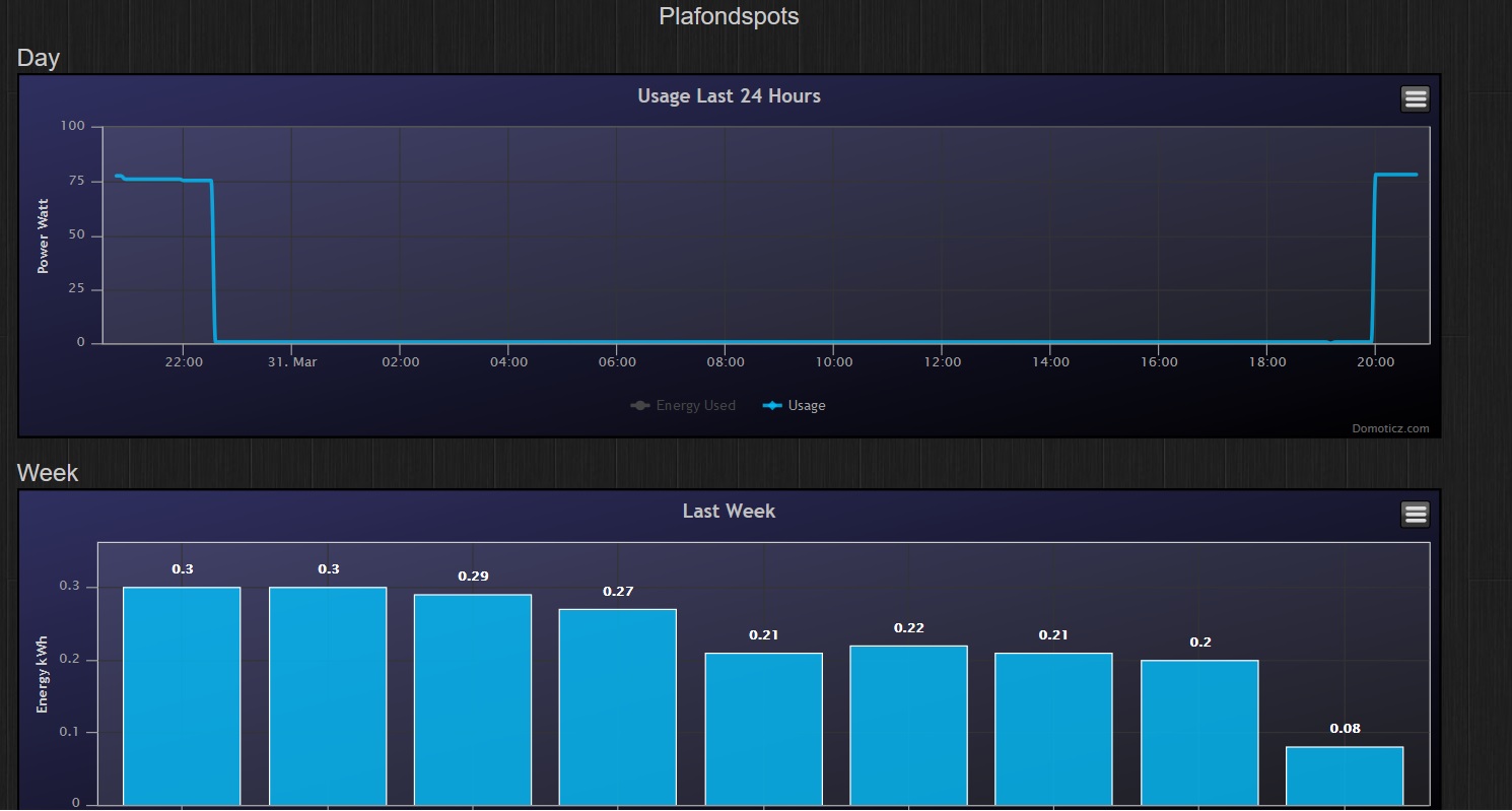

Oops.
they just came back online. really weird .
maybee a database reset thing.
