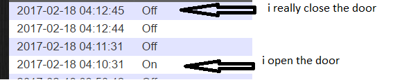

Posted: Saturday 18 February 2017 4:08
by zaraki673
yes door sensor says close after 1minutes open while door is always open ...
- xiaomi-error.png (9.51 KiB) Viewed 2952 times
Posted: Saturday 18 February 2017 4:16
by corbin
can you post the logs from the time the state changed to closed but the door was open?
Posted: Saturday 18 February 2017 4:21
by zaraki673
status log is enough ?
2017-02-18 04:10:31.838 {"cmd":"report","model":"magnet","sid":"158d0001082b75","short_id":23864,"data":"{\"status\":\"open\"}"}
2017-02-18 04:11:31.696 {"cmd":"report","model":"magnet","sid":"158d0001082b75","short_id":23864,"data":"{\"no_close\":\"60\"}"}
2017-02-18 04:12:44.100 {"cmd":"report","model":"magnet","sid":"158d0001082b75","short_id":23864,"data":"{\"status\":\"close\"}"}
2017-02-18 04:12:45.313 {"cmd":"heartbeat","model":"magnet","sid":"158d0001082b75","short_id":23864,"data":"{\"status\":\"close\"}"}
Posted: Saturday 18 February 2017 10:01
by Mat2Vence
zaraki673 wrote:yes door sensor says close after 1minutes open while door is always open ...
Same issue on my side. It uses to be the case 2 weeks ago with one beta release, and the issue was fixed with the next beta.
I am nnnow running with the 3.6745 and the doors are switch back to closed from domoticz when the status from xioami is open (and by the way the doors are physically open).

What's look a bot strange is that I have 5 door sensors and I am seeing the issue on 4 of them and not on the last one that remains with the status open..
Onre more comment after some other tests.... it looks like when you open the windows, the sensor is automatically switch back to closed aftr 1 minute, but then (probably after en refresh from the xiaomi gateway) the status is back to open, et remain open till the windows is effectively closed.
