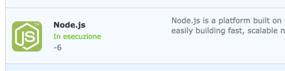

Hi @jumbotroll
I've installed your spk but...
- mdah still showing the same thing...it needs v4
- installed version of node shows -6
Schermata 2016-11-30 alle 18.39.22.png (37.37 KiB) Viewed 3231 times
- in terminal i get this:
root@DiskStation:~# npm
Illegal instruction (core dumped)
root@DiskStation:~# node -v
-ash: /usr/local/bin/node: No such file or directory

Ok, it was only a test, maybe it's not working.
you can try to type /usr/local/bin/node ./node -v

mmmm a good new...
root@DiskStation:~# /usr/bin/node -v
v0.12.2
i try to put it on path...let me try

mmm bad news...
admin@DiskStation:~$ sudo node
Illegal instruction
admin@DiskStation:~$ node -v
v0.12.2
admin@DiskStation:~$ sudo -i

by jumbotroll
Sorry to say, but your NAS is not supporting new compiler.When I try to compile Node version 4.x i get: WARNING: C++ compiler too old, need g++ 4.8
Your NAS is using g++ 4.6.

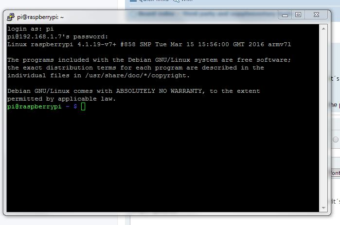

Posted: Thursday 08 December 2016 19:16
by Rena
Running a Rasp 2 for a year with Domoticz and it works fine and now it´s time for me to install imperihome. I´m not a Rasp-expert so first of all a simple question.
How do I change directory so I can go to /etc/mydomoathome/ from the putty terminal? "Cd" doesn´t work, why?
I would like to edit the config-file in mydomoathome diretory with nano.
I have tried to edit the file via Filezilla but that´s not the correct way.
I only have one user on my Rasp, it´s the "pi" user.
Re: [MyDomoAtHome] Support thread
Posted: Thursday 08 December 2016 19:20
by epierre
just do :
nano /etc/mydomoathome/config.json
unix is case sensitive, so cd is cd not Cd
