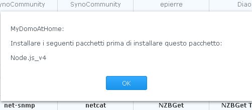

I'm playing with a domoticz installation on my Synology DS211j.
I'm trying to find a possible solution to MyDomoAtHome that do not install...and the problem is nodejs.
The last installable version is the 0.10 but MDAH requires v4...and ARMv5 (my cpu) isn't more supported by node.
What workaround can i apply to use only synology and imperihome app?
Is there an old version of mdah i can use?
Thanks in advance for your help :)

@kubrik aren't you DSM6 ? in DSM6 you have the right nodejs see: https://www.synology.com/en-global/supp ... oad/DS211j
for those in DSM5, there is this one: http://www.e-nef.com/domoticz/mdah/node ... 0.1.56.spk

hi @epierre thanks for your reply.
I've installed nodejs 0.10.
When i try to install MDAH it fails telling that needs v4.0...
Take a look at screesnhots.
DSM 6.0

yes from DSM6 there is a nodejs_v4 package available
https://www.synology.com/en-global/dsm/ ... Node_js_v4
but right DS211J is not in...
you have the 0.12 which is good too (0.10 is to be dropped...) :https://www.synology.com/en-global/dsm/ ... es/Node_js
and try the above package and tell me if it works, or I'll resubmit one with DSM6 path and 0.12

I can only see 0,10 version as screenshot...i press update into package center but the 0.12 version isn't showed...
How can i download and manually install this 0.12 version?

this should be developer category in the package manager, don't know more...

I can confirm that for armv5 the last version is 0.10.
It can be see browsing here:
http://download.synology.com/download/Package/spk/
Probably the 0.12 was broken and removed:
https://forum.synology.com/enu/viewtopic.php?t=106230
AMRv5-based Synology NAS (like the x11 models) can only compile Node.js version 0.10.x (See New Node.js 0.12 package is broken on Armada370)
More recent ARM models support node v.0.12.x

I don't have the link here but they were out before from the community, don't know your arch name:
https://synocommunity.com/package/node
armv7 crashes on armv5 (arm v5 is PI 1 (and 2?)...)

Linux DiskStation 2.6.32.12 #8451 Wed Aug 17 05:12:01 CST 2016 armv5tel GNU/Linux synology_88f6281_211j
