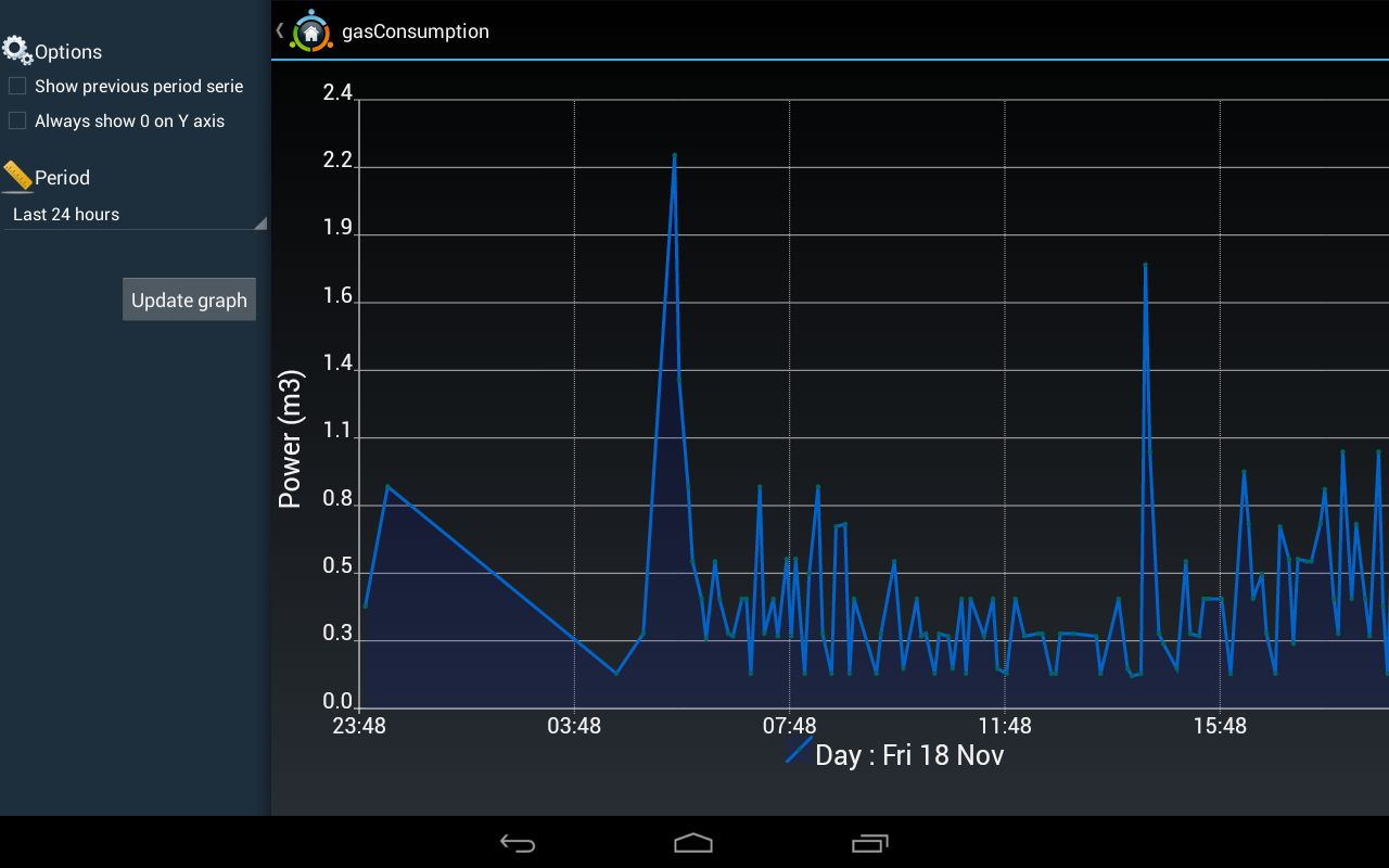

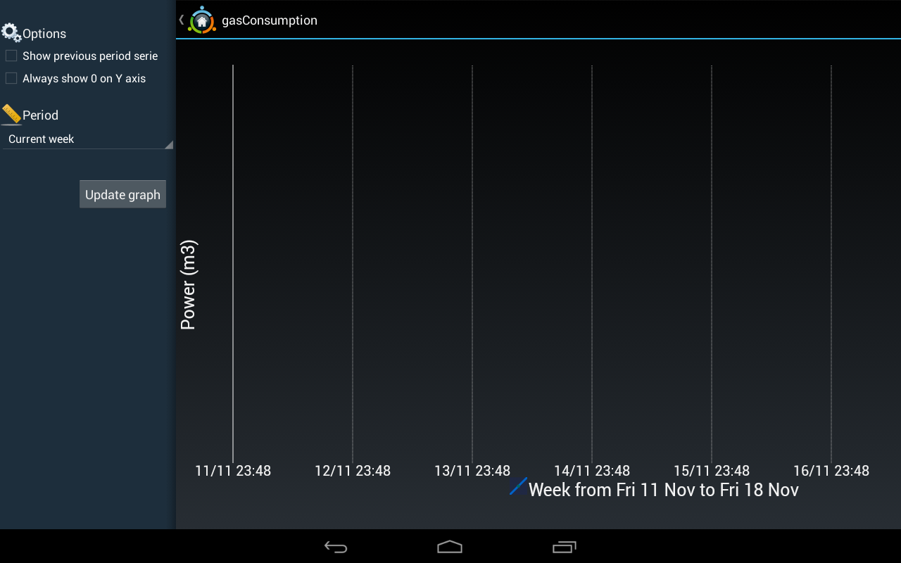

As you can see from the screenshots attached, the graph for the week is kinda empty, whereas the 24H graph is not...
Any ideas why?

As one can see from the above Domoticz replies, the data is made available by Domoticz in any case: week or day, whatever. However, only the graph for 24H is created properly in ImperiHome, all the other periods fail.
No idea why... May be you, epierre?

@all some were incorrect, something has changed in domoticz for all related to rfxmeter (was bad everytime).
but for week it works for me, so without a database to play with I cannot investigate further..

uh found... special device with now a new mapping,...epierre wrote:@all some were incorrect, something has changed in domoticz for all related to rfxmeter (was bad everytime).
imagine if it is a single sensor it is:
day: d u
week: d v
month/year: u_max and u_min
if composite:
"d" : "2015-11-19",
"v1" : "264",
"v2" : "1776",
"v3" : "24",
"v4" : "192",
"v5" : "288",
"v6" : "3096"
headache...

hanryz
- Posts: 27
- Joined: Monday 31 October 2016 23:18
- Target OS: Windows
- Domoticz version: 3.5837
Re: [MyDomoAtHome] Support thread
I tried the latest of MyDomoAtHome I checked out from your git repo.
Now - I get empty graph even for 24H (it was ok before). Still no luck with other periods (week, month year).
I tried then the latest of Domoticz 3.5964, same effect there...

@hanryz without your database I can't do anything anymore... fixed issues for some graphes I had, looks it did not for you.
@epierre: just sent you the domoticz-db file to domoticz at e-nef.com. Please have a look. Merci.
- epierre
- Posts: 522
- Joined: Wednesday 05 March 2014 13:16
- Location: France
ok new version from yesterday that should fix missing curves
